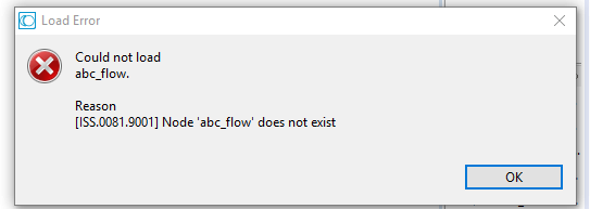

    After trying to create a local service development, the package reloads and denotes an Error: [ISS.0081.9001] Node does not exist

  • 7.  RE: Missing Package contents in IS after creating in local service
    Posted Wed March 14, 2018 10:48 AM
    Hi,
    I am also facing same problem, I dont see any actual solution for this.
    1. I created one service “MyTest.testservice” in Designer 10.1
    2. Executed/run the service successfully.
    3. I did right click on package name MyTest > ‘Create Local service Development Projet’ > provided all necessary details like Repository, Working tree, path within repository.
    4. When I click on Finish I get the error pop-up (as per details below).
    5. If I click on the Package “MyTest” to explore the services, I don’t see anything inside the package.
    Could not load
    testservice.
    Reason
    [ISS.0081.9001] Node testservice does not exist
    Please share the solution if available.

  • 8.  RE: Missing Package contents in IS after creating in local service
    Posted Fri March 16, 2018 07:04 AM
    In my case, below solution worked.
    Root Cause:
    After checking in the Designer workspace log file (C:\Users\hukam\workspace101.metadata.log), I found below message:
    !ENTRY com.softwareag.is.vcsintegration.showfiles 4 0 2018-03-16 14:32:13.093
    !MESSAGE C:\SoftwareAG101\IntegrationServer\instances\default\packages\MyTestSuiteDemo: A required privilege is not held by the client.
    !STACK 0
    java.nio.file.FileSystemException: C:\SoftwareAG101\IntegrationServer\instances\default\packages\MyTestSuiteDemo: A required privilege is not held by the client.
               at sun.nio.fs.WindowsException.translateToIOException(WindowsException.java:86)
    at sun.nio.fs.WindowsException.rethrowAsIOException(WindowsException.java:97)
    at sun.nio.fs.WindowsException.rethrowAsIOException(WindowsException.java:102)
    at sun.nio.fs.WindowsFileSystemProvider.createSymbolicLink(WindowsFileSystemProvider.java:585)
    at java.nio.file.Files.createSymbolicLink(Files.java:1043)
    at com.softwareag.is.vcsintegration.showfiles.actions.MoveProjectToPackageAction$3.run(MoveProjectToPackageAction.java:417)
    at org.eclipse.core.internal.jobs.Worker.run(Worker.java:55)
    it clearly states the reason i.e. “A required privilege is not held by the client”.
    Resolution:
    I started the Designer as Administrator (i.e. right click on Designer icon and then choose option ‘Run as Administrator’), it started working for me :).
