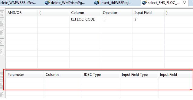

  • 15.  RE: Migrating webMethods 8.2 to 9.8
    Posted Wed May 18, 2016 07:40 AM
    Hello Team,
    We are migrating from 8.2.2 to 9.8. After migrating the JDBC Adapters, we noticed that the WHERE Tab for Update, Select and Delete adapters do not have parameters listed (bottom part) which causes errors when trying to test the services. Is there a way to solve this migration issue? or do we really need to update all adapters migrated to add/reload all the parameters?
    Kindly see attached screenshot for reference. The missing parameter is enclosed in the red box.
    The adapter version in wM8.2.2 is 6.5.
    **Note: Reading the previous posts on this topic, there was a suggestion to update the Adapter version to 9.0. Do we need to update the adapter version at wM8.2.2 from 6.5 to 9.0 before we migrate the adapters to avoid the missing parameter issue?
    Appreciate your help! Thanks!

  • 16.  RE: Migrating webMethods 8.2 to 9.8
    Posted Wed May 18, 2016 09:18 AM
    Hi,
    JDBC Adapter 9.0 ist not available for older wM Versions before 9.x.
    There is an additional migration script to be run to migrate the adapter services from 6.5 to 9.0.
    This should be mentioned in the documentation of JDBC Adapter 9.0.
    As a second approach you can drop and recreate the adapter services.
    Regards,
    Holger
