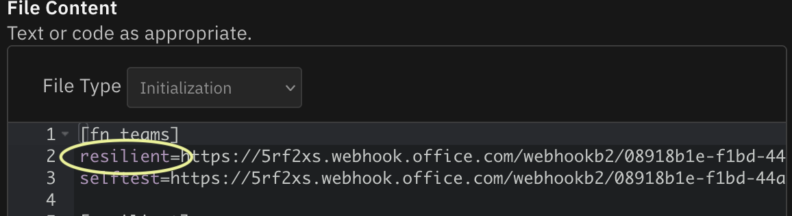

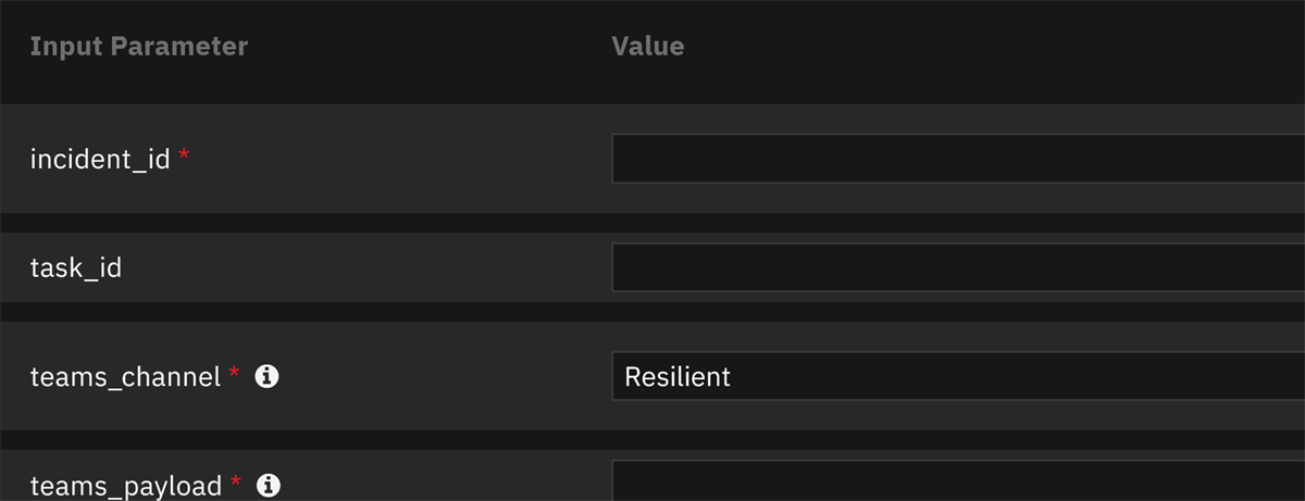

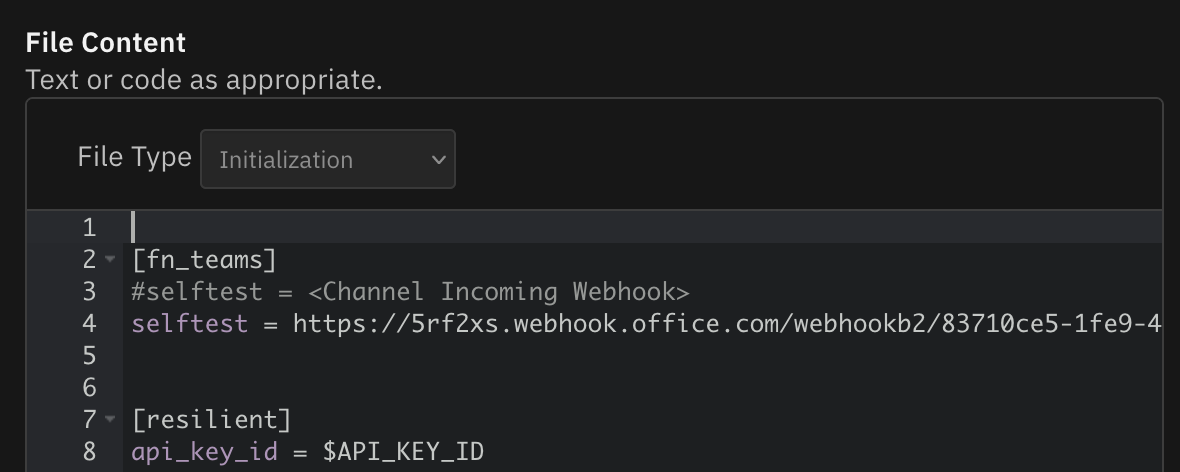

I have the same problem as Paweł, but nothing from recommendations work on my end. I've tried all possible combination for the webhook and channel name, but no luck.

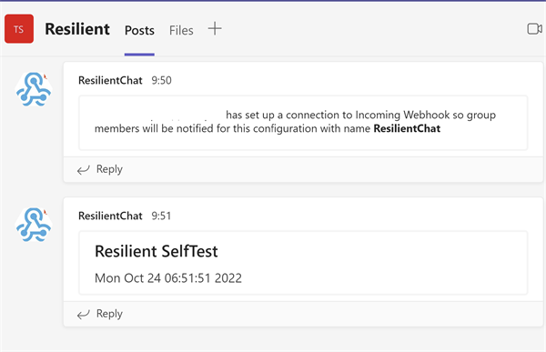

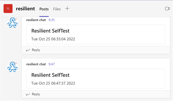

As you can see from the screenshots, the self test works correctly, but I always get an error when I try to submit an incident.

The existing implementation of the selftest function is slightly outdate, and so we are unable to see exactly what the error is in this case. Irrespective of that,
the actual problem here could be due to incorrectly configured "Incoming webhooks". To properly generate this "Incoming Webhook" for a channel, you can follow this link https://learn.microsoft.com/en-us/microsoftteams/platform/webhooks-and-connectors/how-to/add-incoming-webhook. This then can be set to the "selftest" options in the app.conf file. A screenshot of this has been attached for your reference.

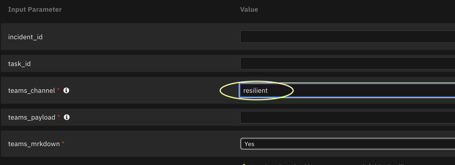

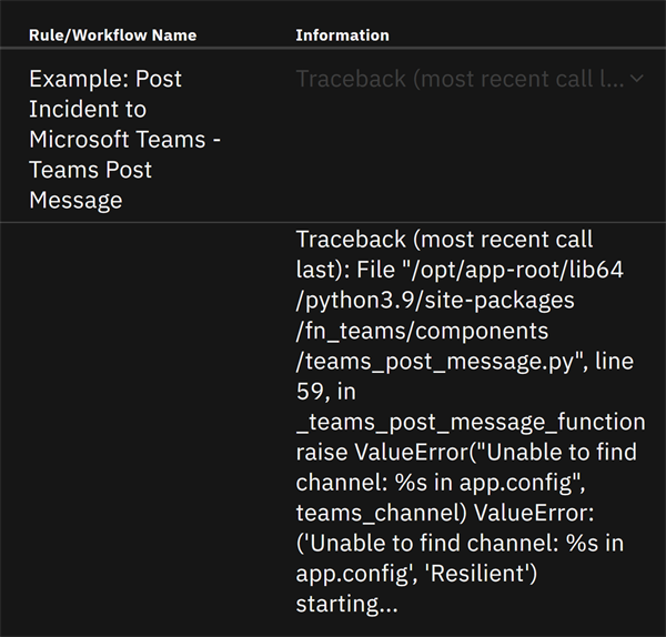

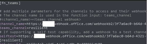

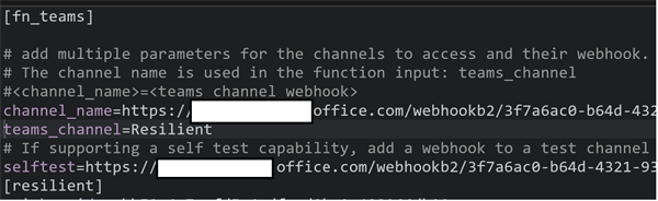

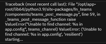

Based on the error, it looks like you placed the webhook url in the function 'teams_channel' input field rather than the label ('channel_name') you specified in the app.config. The label is meant to be an easier way to refer to the webhook url.

Thank you for the answer. I already created webhook on teams and tested from powershell - it's working. My team called Resilient Integration and the channel is Incidents.
I configured app in apphost as you see on the screenshot below. But I get errors (2nd screenshot).
What could be wrong? On last screenshot you can see results of selftest.

The first place you're going to start is configuring your app.config file with the Microsoft Teams' webhooks. Each webhook will refer to a different channel for sending messages. You will label your channels in any meaningful way for your use. This link would give you information on setting up a webhook. https://docs.microsoft.com/en-us/microsoftteams/platform/webhooks-and-connectors/how-to/connectors-using.
[fn_teams]
channel_name=<teams channel webhook>
Within your workflow, you'll setup your function to indicate which Teams channel you're sending content to. The example workflow shows how data can be formatted into the format the webhook requires (an ActionCard). You should be able to run the example rule and workflow to get a feel for the formatting required and then you can create your own format as necessary.
