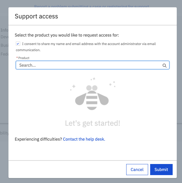

  • 3.  RE: Memory leak on connection (MQCONNX) failure when `cd.SSLCipherSpec` is used
    Posted Wed June 24, 2020 06:32 AM
    Please also raise a case/PMR with IBM in order to get it fixed.
    It seems I can't create a case/PMR since I'm not using the MQ product myself (I can't select any product):
    Alexandre YANG
