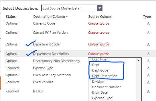

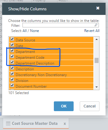

    However, on the Map Column step, I cannot see the "Department" column against which I would have liked to map the "Dept" column (refer Map Column step screenshot), even though the "Department" column actually exists OOTB on the Cost Source Master Data (refer Show/Hide Columns screenshot)
    ... now what @Oliver Smith suggests works (thanks a ton Oli ). I can use the "Add Custom Column" option to map the "Dept" column to Cost Source Master Data and provide a suitable column name ... however, this approach does not show the user that a column by the name of "Department" already exists OOTB on the Master Dataset. If the Map Columns step listed all the 'Destination' columns, a user would have simply mapped it to the correct OOTB column.

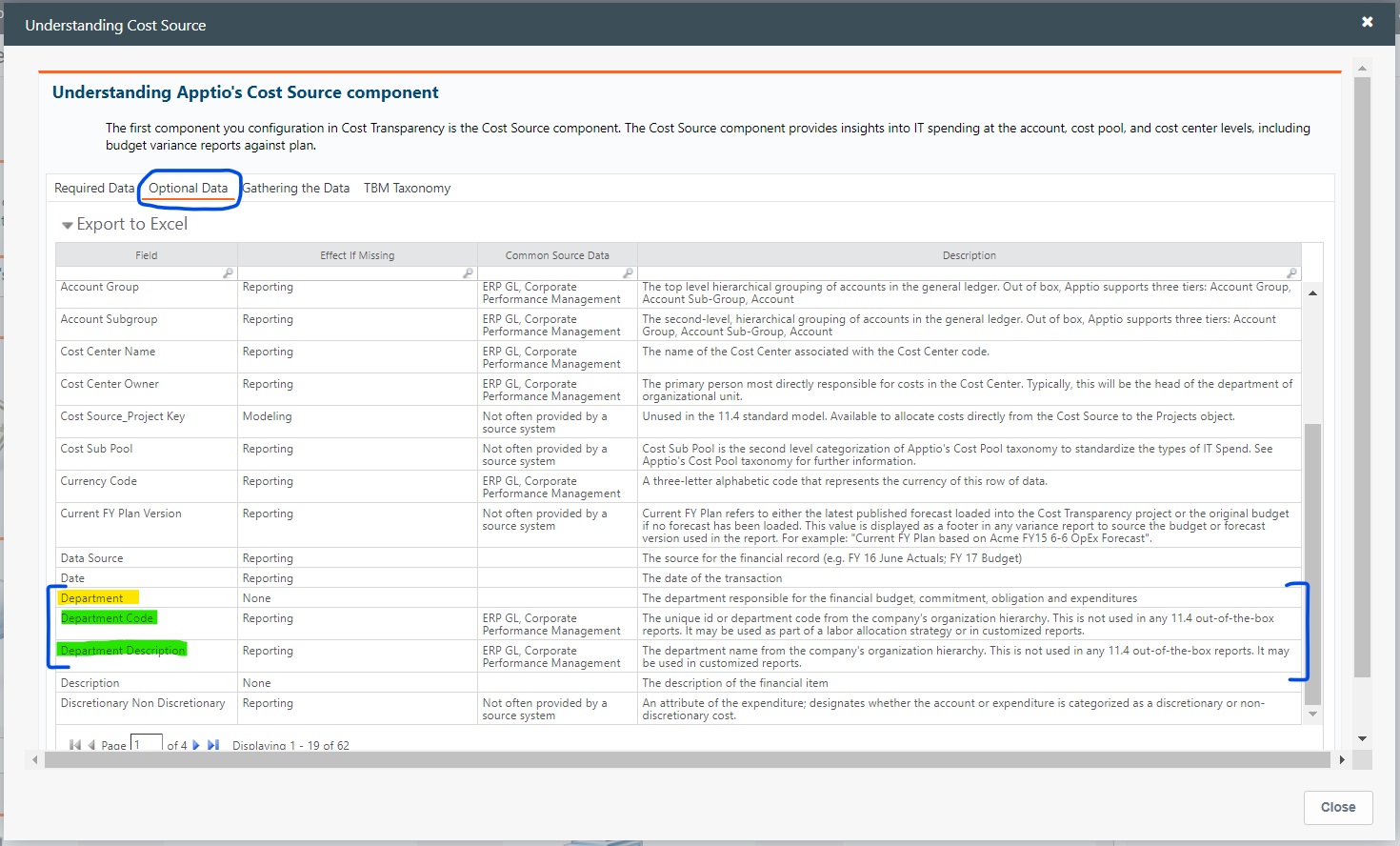

    Aha! Now I understand the question. The Department field is not configured (OOTB) to be either a "required" or "optional" field in the Cost Source Master Data. Only those which have been configured as such will be shown in the Destination column list.
    #Platform
  • 13.  Re: Map Columns missing Master Dataset columns
    Posted Tue December 17, 2019 06:18 PM
    @John Adipietro
    Weird that Apptio would include Department Code and Department Description fields, but not the Department field.
    Also,  per Data Advisor - all three department fields are "Optional".
    #Platform
  • 14.  Re: Map Columns missing Master Dataset columns
    Posted Tue December 17, 2019 06:46 PM
    Thanks for pointing this out! Sounds like maybe we intended for that to be included, so it might be worth opening a support case to bring it to attention of our product team.
