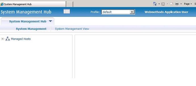

    Hi
    We have CentraSite installed on Unix . There are two CentraSite nodes and registry is clustered in an active/passive mode across the two nodes. The SMH on active node should ideally display both the host machines. While logging into SMH I am not able to view any of the nodes on which CentraSite is installed. I only see a blank page. I need to restart registry through SMH but since node is not visible I am not able to. As of now registry is down . The inoadmin command is also throwing following error
    $ ./webmethods80csasoa/CentraSite/bin/inoadmin start CentraSite
    INODST1751: (ARG0401) Cannot find language library (language resource not installed for product).
    INODSI2271: (ARG0401) Cannot find language library (language resource not installed for product).
    INODSE2241: (ARG0401) Cannot find language library (language resource not installed for product).
    INODSF1436: (ARG0401) Cannot find language library (language resource not installed for product).
    As such I am not able to login in CentraSite Control and getting the following error, since I am not able to restart registry.
    Connection handler com.centrasite.control.login failed to establish connection.
    Reason: Database access error. Can’t connect to server CentraSite.
    Plug-in com.centrasite.control has been disabled
    Thanks and regards
    Karan Sharma

  • 2.  RE: Managed Host nodes not visible on SMH
    Posted Wed February 15, 2012 06:34 AM
    Hi Karan,
    I think you have a problem with your apache.
    Check if it is running and also verify your hostname and domain name are correctly set.

  • 3.  RE: Managed Host nodes not visible on SMH
    Posted Fri February 24, 2012 10:29 AM
    Hi Karan,
    Shuaib is right, the apache needed to access CentraSite seems to be not running, please start the corresponding daemon in /etc/init.d. In addition, before you can run run the inoadmin script you need to parse the centrasite_setenv.sh file in the /CentraSite/bin directory, e.g. via “. centrasite_sentenv.sh” on Unix/Linux.
    Regards,
    Gerald

  • 4.  RE: Managed Host nodes not visible on SMH
    Posted Fri February 24, 2012 11:01 AM
    Hi Gerald\Suhaib,
    I was able to resolve this issue with exactly the same steps as suggested by you. Since we have many environments where Centrasite is running, in one these environments I even tried out replacing the regfile with regfile_bck which worked then and I was able to bring up Centrasite Registry using inoadmin command. Thanks a lot for your help.
    Regards
    Karan
