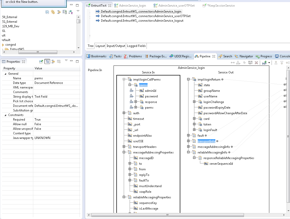

    Dear Team,
    I have a problem when calling a webservice on IS.
    This service have a login method and other methods, before calling other methods, we need to call login method to log in.
    In java, I just need do like this:
    1. Create binding
    2. Set binding.setMaintainSession(true)
    3. Use this binding to call the login method
    4. Use this binding to call other method.
    I don’t know how to do it on IS, I tried to create a consumer, create a flow to call one by one service (login + other), but it’s failed (Login is passed, but next method will receive result as not_logined).
    So any one can share how to make it run ?
    Thanks for your time!

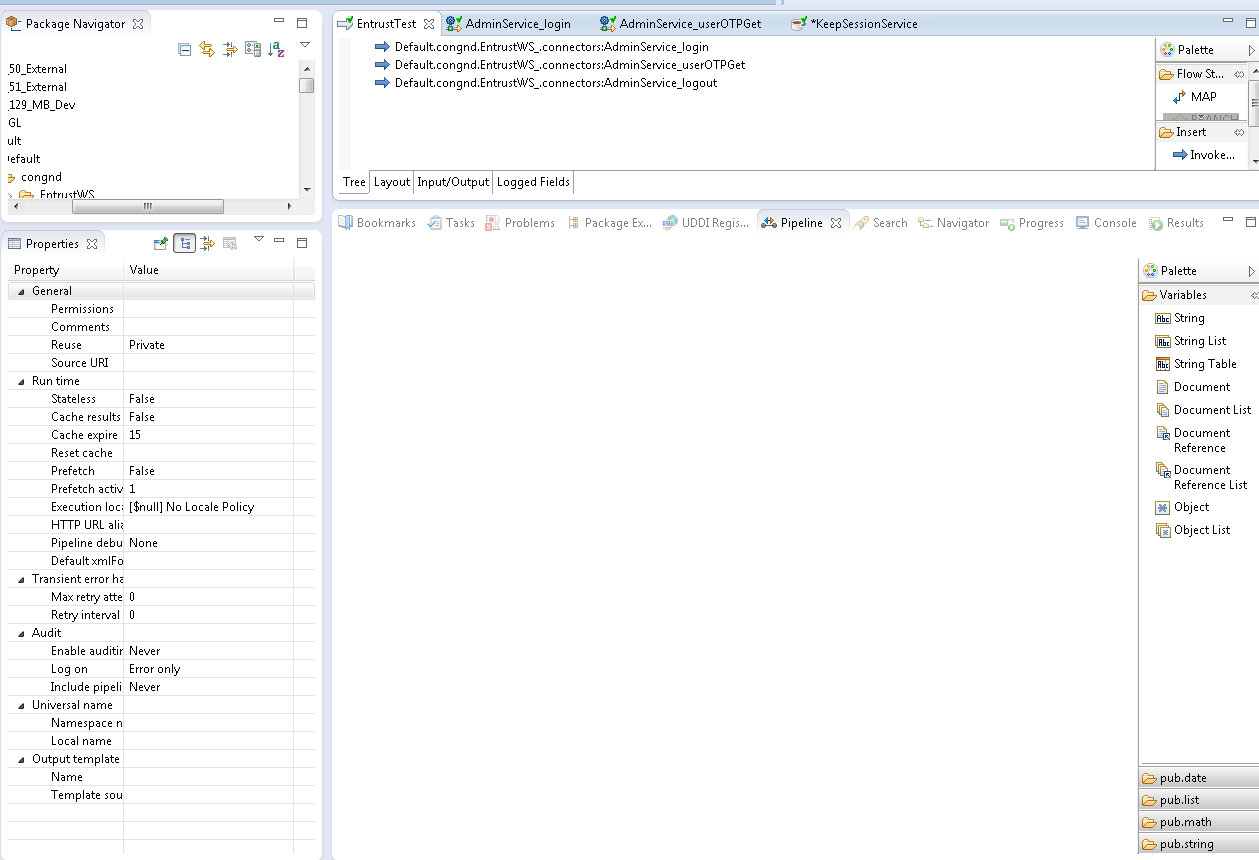

    If you are working with webMethods flow service then there will be property called stateless you need to set it as “false”
    Also make sure all the child services which are being called should have this property set as false.
    Regards,

    Hi Ahmed,
    Thanks for your response. But I have checked code, it had already set like that, but it doesn’t work. :frowning:

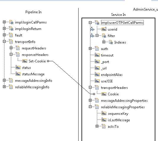

    I found out the solution, you can see in the attachment.
    Thanks for your help :wink:
