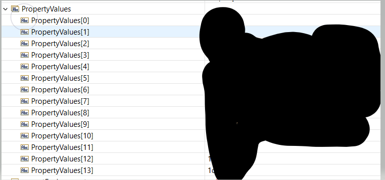

    I have a string list which has 13 elements in it as shown below.
    I need to loop through this and get the nth element and assign it to an out variable.
    eg: I need to map and assign as below.
    PropertyValues[1] to an out variable var1
    PropertyValues[4] to an out variable var2
    PropertyValues[6] to an out variable var3
    PropertyValues[8] to an out variable var4
    PropertyValues[10] to an out variable var5

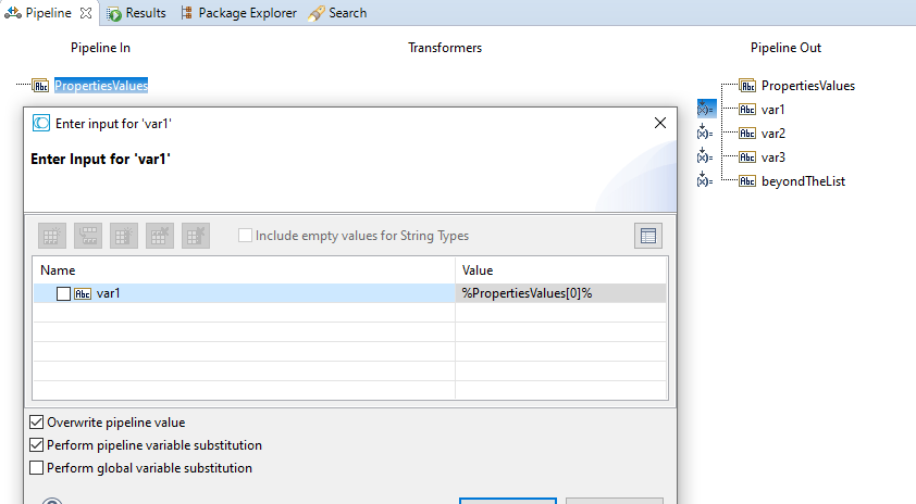

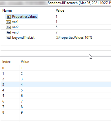

    You can use variable substitution. It has some caveats to be aware of (repeating the substitution string multiple times, impacting maintenance; if the list isn’t full, target vars will have the variable substitution string assigned as a value, etc.). If the positioning of which index goes to which var changes, then this approach silently breaks.
    Here is the result of a sample where one of the variables references an index that is larger than the list size.

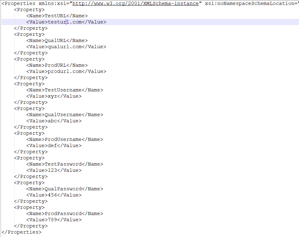

    That is correct. This is read from an XML config file which has the name/value pairs stored for URL, username, Passwords for different environments. And yes, I have control of this file and it won’t be changed. The positioning of the parameters will not change in the config file even though the values inside might change.
    So, basically the purpose of this is, I have a config file (xml) which has the URL, Username and Password properties stored with values for three different environments.
    In my flow service, I am branching out based on the environment and fetch the URL, Username and Password values for the corresponding environment.
    example of xml file is below:

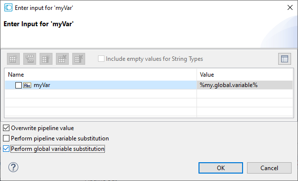

    You can read global variables through variable substitution, similar to pipeline variables.
    For example, to put the global variable my.global.variable into the pipeline variable myVar, create a map step and, in the output side, add myVar and set the value to “%my.global.variable%”. In the lower left corner of the set window, check the “Perform global variable substitution” checkbox.
