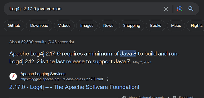

    Please provide more information about the issue you are experiencing with log4j (logs, screen shots of flow and/or error, etc…). As log4j is a java library and webMethods is a java product you should be able to use any library without any problems as long as that library supports the environment java version. For that you need to check the documentation of the library you are using. A simple google search will give you that answer.

    As Java 1.8 and Java 8 are equivalent to each other, this should not be the problem.
    More likely there is a classpath conflict when log4j/log4j2 is delivered with the webMethods Suite and if you added the log4j2 jars manually in addition to the deliverd one.
