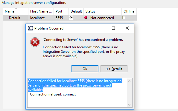

  • 1.  Localhost Integration Server
    Posted 01/21/18 06:13 PM
    I get error “Connection failed for localhost:5555 (there is no Integration Server on the specified port, or the proxy server is not available)” when I try to connect integration server

  • 2.  RE: Localhost Integration Server
    Posted 01/26/18 07:05 AM
    Hi Serhat
    Did you started IS already ?
    Can you open a command line and try Telnet localhost 5555 ?
    Or you can try the browser http://localhost:5555 ?

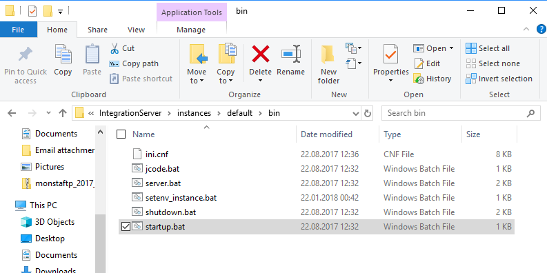

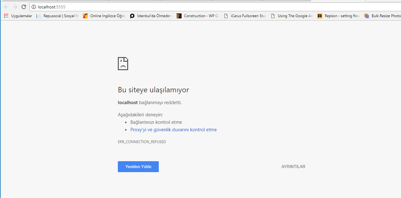

  • 3.  RE: Localhost Integration Server
    Posted 01/26/18 09:05 AM
    Hi Onur ,
    Thank you for your reply .
    I tried to start integration server by clicking the file you can see IntegrationServerStart.png but it didn’t work .
    When I try telnet , I get “Could not open connection to the host , on port 5555 : Connection failed”
    I try on browser but I get the error in localhost.png (attached file) .

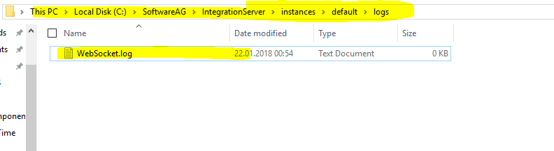

  • 5.  RE: Localhost Integration Server

    Posted 01/26/18 10:26 AM
    Hi Serhat,
    which version of IS are you using?
    We will definitely require the content of C:\SoftwareAG\profiles\IS_default\logs\wrapper.log for further analysis.
    Regards,
    Holger

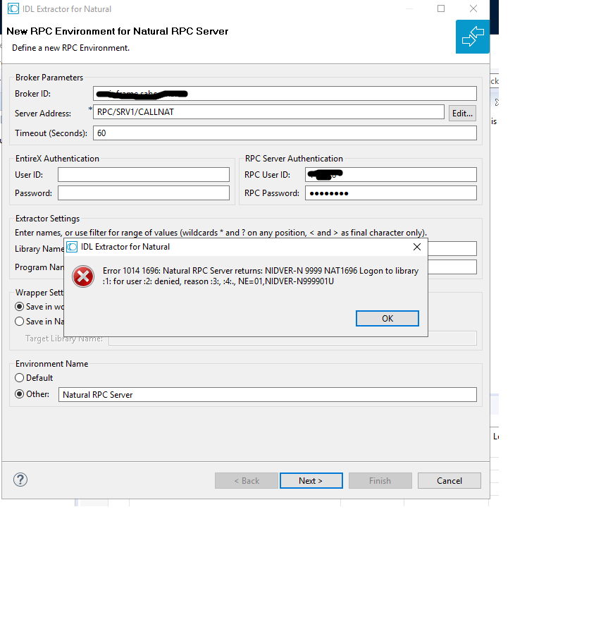

    Hi Kalpesh
    Thank you so much for the reply; so managed to figure out what I needed to use was the Natural IDL selector and not the webMethods one, but I’m now having a different issue; please see screenshot below:
    Any idea what that error is/means? I’m able to ping the mainframe so it is visible to other computers on the network.

  • 12.  RE: Localhost Integration Server
    Posted 09/10/20 03:45 AM
    NAT1696 means what it says on the tin: “logon to library denied”.
    This message doesn’t show the reason code, so try to log on with the given credentials interactively and you should see the real cause.

  • 13.  RE: Localhost Integration Server
    Posted 09/10/20 05:29 AM
    Hi Wolfgang
    Tested logging onto the mainframe with the credentials and this logged on fine with no issues. Is there any other way I could determine the reason for logon being denied?

  • 14.  RE: Localhost Integration Server
    Posted 09/10/20 05:31 AM
    Darryl,
    check the RPC server log, you’ll probably find a more complete message, including the reason code, there.

  • 15.  RE: Localhost Integration Server
    Posted 09/10/20 06:19 AM
    Thank you Wolfgang, will do so!
    Apologies for all the questions; I’m fairly new to EntireX and the mainframe side of things.

  • 17.  RE: Localhost Integration Server
    Posted 09/11/20 07:15 AM
    Hi Wolgang
    Problem resolved; the account I was using was not setup correctly with Natural Security. Thank you so much for your help! :slight_smile:
