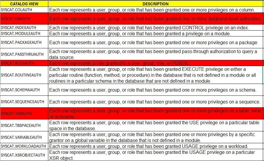

    I concur with Phil in his response above....you probably want data out of the SYSCAT views for your audit.  Below is a little spreadsheet of the 'AUTH' views you would most likely want to consider...those highlighted in red being the most likely.
    Andy
    Andy McLaughlin
    Great American Insurance
