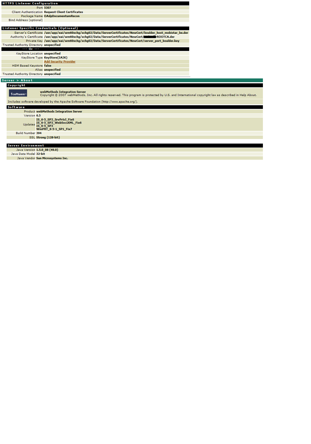

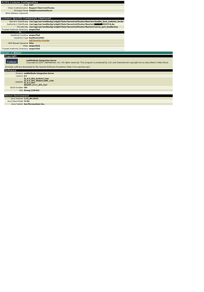

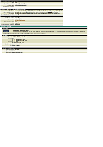

    Actually, I created a new private key and csr using openssl from the server and using that csr we got the server certificate from our client. But when I configured the same in the port, it is not getting enabled. PFA the port configurations.
    After some analysis, I found out the new private key might be the source of the error. This is because the port got enabled when I used the old private key and new certificates.
    I am assuming I need to import the new key in the keystore (IAIKKeyStore) of the port.
    Am I correct in my assumptions? Can you help me in importing the key in the keystore?
    If not, then can you advise on what to do next?
    Please take into considerationthe wM version.
