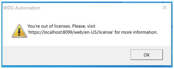

    This is not a question but a problem and solution I have found.
    After installing WDG Studio, the WDG Automation service is installed but set to "Automatic Delayed". This means if you fire up Studio, you may get the following error message if the service has not yet started.
    So what I did was to set it to "Automatic" so that there is no delay and Studio can then start.

    Thanks for the tip, Justin.
