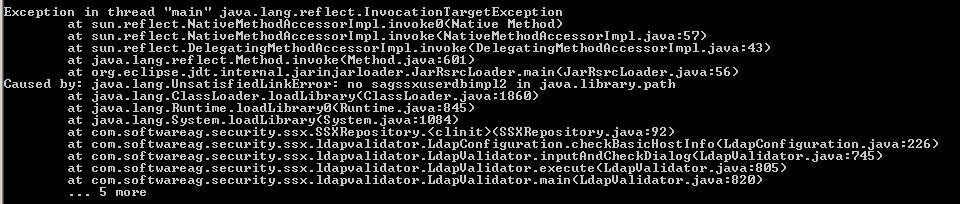

    I still have issues here is the error I get when running the command giving it the proper ldap server and then host port. I selected 1 for Active Directory and then when it tries to connect I get a dump see attachement.
    I:\SoftwareAG\jvm\jvm170_32\bin\java -jar SsxLdapValidator:

    The exception is caused by the fact that your environment variables are not set up correctly. To fix that you need to do the following:
    1. Copy SSXLdapValidator.jar to the bin directory of your CentraSite installation
    2. Execute centrasite_setenv.cmd in the CentraSite bin directory
    3. Execute SSXLdapValidator.jar in the CentraSite bin directory
