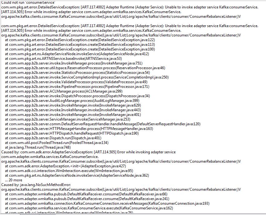

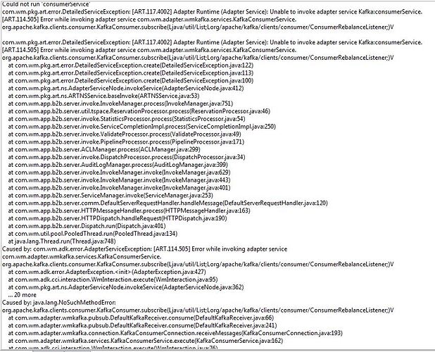

    Hi Team,
    I have created a sample consumer service in webMethods Designer using “Kafka Consumer Connection”.I was able to execute Producer service and produce message into a topic.But,while executing consumer service by providing topic name as input,the following error is encountered.Could anyone help me out in finding solution for this issue.
    Please refer the screenshot attached for error details.

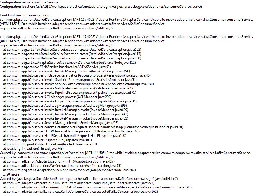

    Hi Sindhura,
    Kafka adapter only supports the following Kafka server version.
    Apache Kafka 0.9.0.x
    Apache Kafka 0.10.x.x
    Apache Kafka 0.11.x.x
    Apache Kafka 1.x.x.x
    So make sure you’ve taken the client libraries(*.jar) from your Kafka server that runs on these versions.
    AFAIK, your error was due to Caused by: java.lang.NoSuchMethodError: org.apache.kafka.clients.consumer.KafkaConsumer.assign. I suspect you’re using kafka-clients.jar file that the version is not supported.
