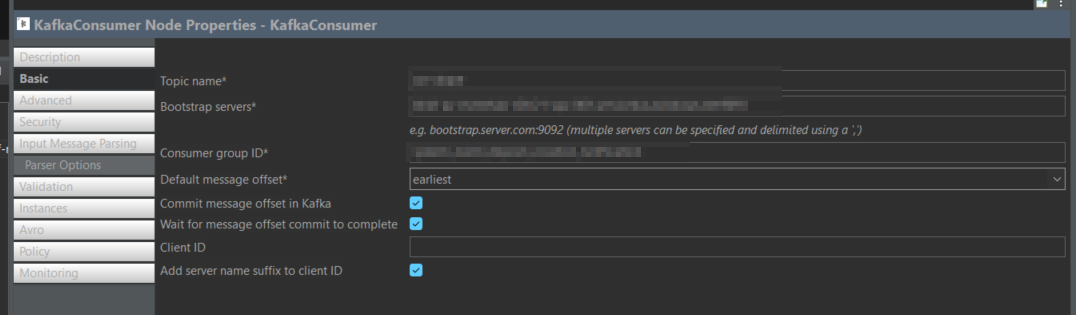

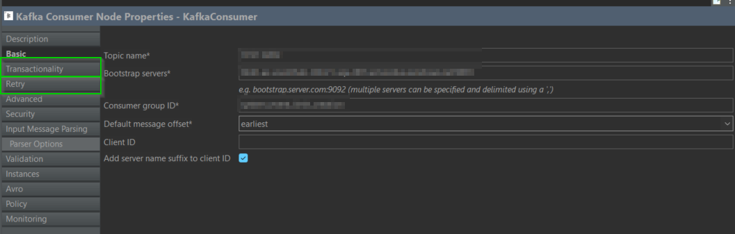

    But I realized that the node has changed from v12 to v13:
    V12
    V13

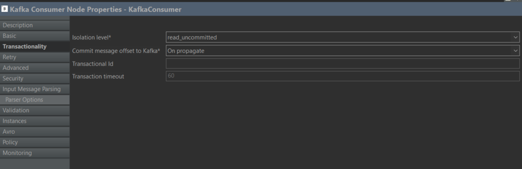

    The warning message disappears from the log with the configuration below:
    The flow keeps the properties from the previous one, which is different from other nodes that automatically update some properties.
