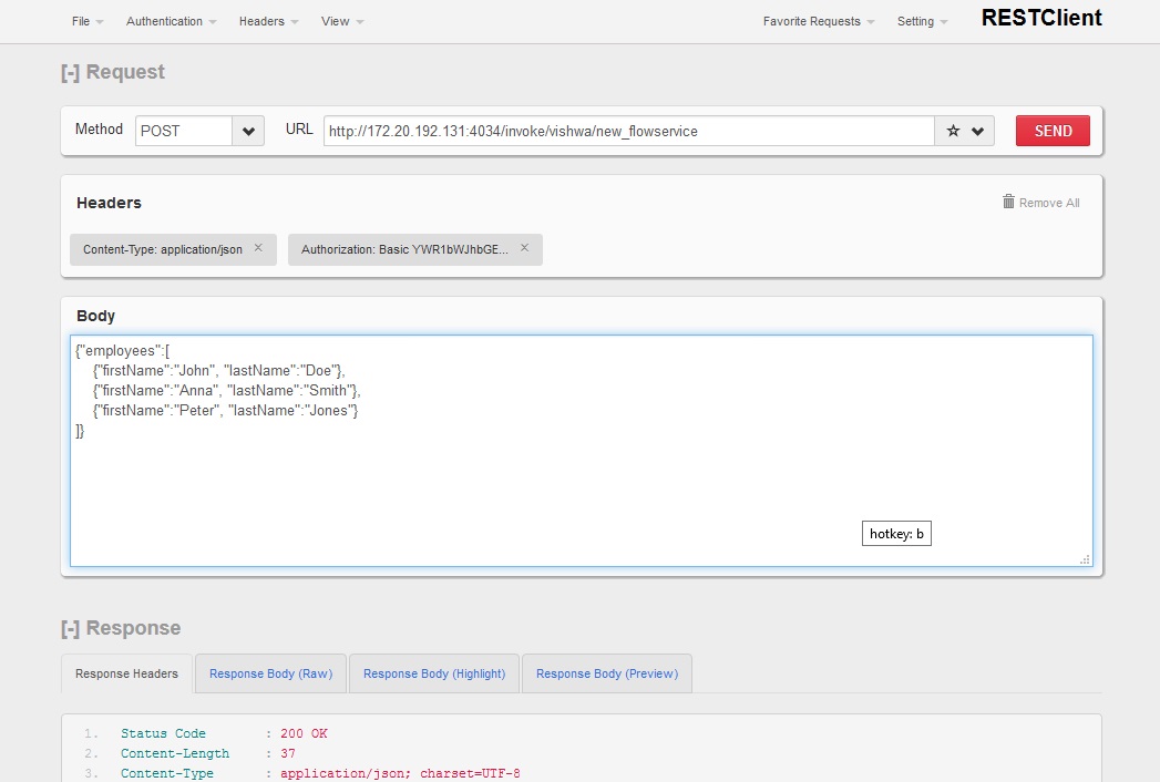

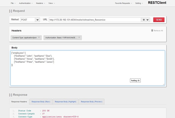

  • 5.  RE: JSON input stream does not start with the \"{\" character.
    Posted Tue May 17, 2016 07:00 AM
    Dears,
    First thing these special characters comes when we don’t put in proper format while running service.
    tHIS Message it seems that you are giving value to a JSON Stream which will not work.
    For successful implementation.
    Please find the snapshots to implement HTTP using JSON Request Call.
    For pushing request use REST Client.
    Note:While making setResponse2 hardcode Content-Type=‘application/json’.

  • 6.  RE: JSON input stream does not start with the \"{\" character.
    Posted Tue May 17, 2016 07:40 AM
    Hi,
    The approach which you have mentioned works when you have named document or document List input fields. Here the requirement was to accept unnamed JSON list input for which Software AG provided a fix, without which IS wont accept JSON List input.
    Please see the input i have mentioned below for clear understanding of the issue.
    Our issue is resolved.

  • 8.  RE: JSON input stream does not start with the \"{\" character.
    Posted Tue May 17, 2016 03:11 PM
    Dear,
    This Service will also work for the JSon List or Document.
    @jacob You mentioned some input type defined below.
    but it’s not there.
