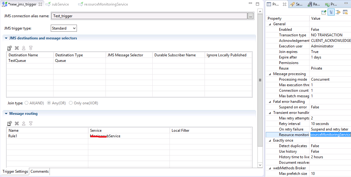

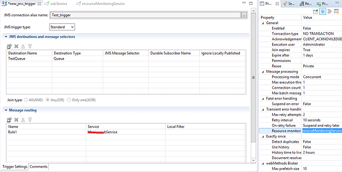

    Hi All,
    JMS trigger is not suspended
    I have set the Trigger property, PFB the snapshot.
    The service is retried for 3 times siuccessfully and logs are wrriten.
    But Trigger needs to be suspended for the above condition but it is enabled.
    Kindly help us on this regard.
    Note: Resource Monitoring service is set in the trigger (isAvailable = True/False). But Resource monitoring also not invoked here.
    Thanks,
    Raj

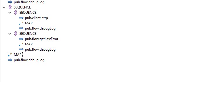

    Can I have a outline of your trigger flow service. Make sure your flow service follows the service outline described in #41 Building Services that Retry in 9-12_Service_Development_Help.pdf

    Hi Mahesh,
    I have a jms trigger pointing to queue with some filter condition. The subscribing service mentioned in the trigger will do a http call
    Messages are picked and lost if the server is down - i.e. http call returns server down.
    I’m trying to build a retry mechanism for trigger along with resource monitoring service. Attached is the screenshot of trigger properties.
    The service is successfully retrying but trigger is not suspended at the end.
    In the resource monitoring service I’m just setting the isAvailable to ‘false’.
    Please suggest if I’m missing anything. why trigger is not suspending?

  • 5.  RE: JMS trigger is not suspended
    Posted Mon January 09, 2017 04:24 AM
    Hello
    Could you please share the logic for your trigger service. I hope you have provided sufficient hint for Integration server to retry for the transient errors. if not, please use, pub.flow:throwExceptionForRetry to mark an exception as ISRunTimeException.

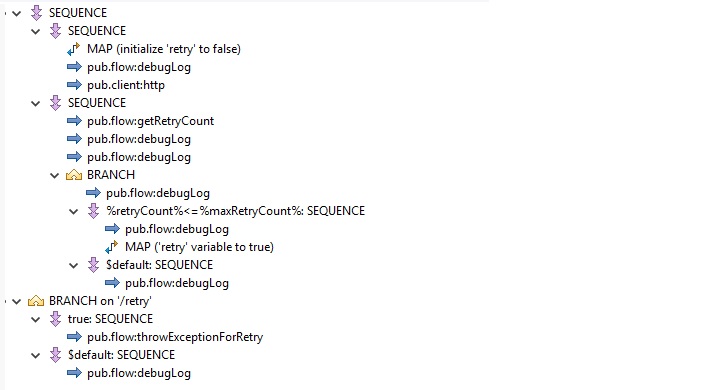

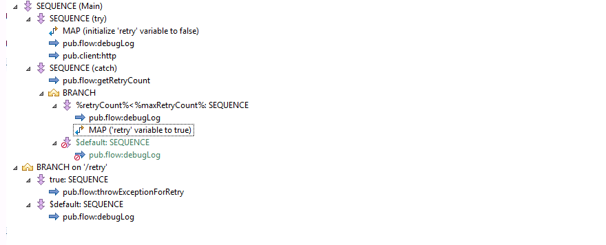

  • 6.  RE: JMS trigger is not suspended
    Posted Mon January 09, 2017 04:54 AM
  • 7.  RE: JMS trigger is not suspended
    Posted Mon January 09, 2017 05:11 AM
    Hi,
    Change the comparison as retryCount<=maxRetryCount as the count will be 0 for both the values in first run.

  • 8.  RE: JMS trigger is not suspended
    Posted Mon January 09, 2017 05:18 AM
    Thanks Satya. That worked.

  • 15.  RE: JMS trigger is not suspended
    Posted Mon May 21, 2018 09:34 AM
    I tried to implement same logic but getting below error.
    [178]2018-05-21 16:59:06 IST [ISS.0134.0042E] JMS Trigger fOLDER:jms_trigger failed: com.wm.lang.flow.FlowException: [ISC.0049.9009] Missing required property switch at ‘unlabeled BRANCH’

  • 17.  RE: JMS trigger is not suspended
    Posted Mon May 21, 2018 11:23 AM
    Check your BRANCH evaluate label property. Set it to true if you want branch on the expressions. Else set it to false, if you want to branch on switch value.
    Please check Service development guide for details.

  • 18.  RE: JMS trigger is not suspended
    Posted Mon May 21, 2018 11:42 AM
    Now that error is resolved but i cannot see trigger is suspended. This is my resource monitoring service and configured in trigger. In this service i have configured pub.trigger.resourcemonitoringspec that returns true/false. I make a 3rd party service call and timing out and then bringing up to see if trigger is suspending or not.
