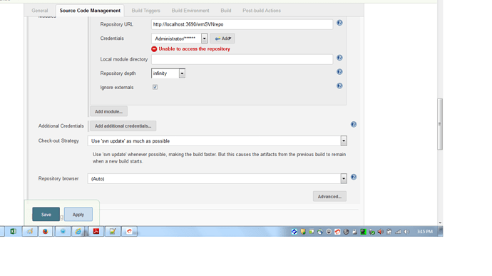

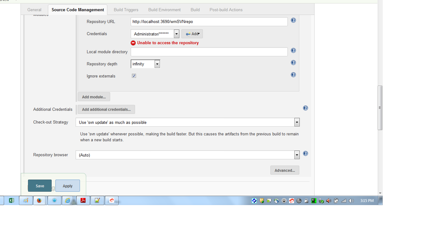

    Hi everyone,
    Currently I am doing POC on deployment using Jenkin.Both ABE and SVN are also used .
    I am getting an error “unable to access the repository” while configuring source code management section using Jenkins .
    SVN repository path is –http://localhost:3690/wmSVNrepo
    webMethods version–webMethods 9.12
    Using designer svn repository is accessible via svn://localhost:3690/wmSVNrepo .
    Can anyone please share your experience or thoughts on identifiying and fixing this issue .

    Hi everyone,
    This issue is now fixed after removing the port 3690.
    SVN repository url–svn://localhost/wmSVNrepo.
