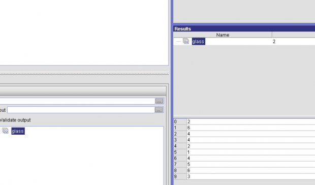

  • 9.  RE: Java Service Developer Issue
    Posted 12/17/12 02:20 PM
    Hmm that looks good, Can you please create a new java service with the following signature? A service with below details is working fine for me.
    Inputs:
    None (no inputs)
    Outputs:
    glass(Integer List)
    [ATTACH=CONFIG]911[/ATTACH]
    IS Code:
    IDataCursor pipelineCursor = pipeline.getCursor();
    List<Integer> tempOutput=new ArrayList<Integer>();
    for(int i=0;i < 10 ; i++){
    tempOutput.add(dice());
    IDataUtil.put(pipelineCursor, "glass", tempOutput.toArray(new Integer[tempOutput.size()]));
    pipelineCursor.destroy();
    Shared Code:
    public static int dice(){
    int dice= (int) (Math.random()*6+1);
    return dice;
    #webMethods
    #Flow-and-Java-services
    #Integration-Server-and-ESB
  • 10.  RE: Java Service Developer Issue
    Posted 12/17/12 02:26 PM
    I copy your code that you post and finnally it work, i didn’t see the result below the glass integer list my fault, thank you very much!
