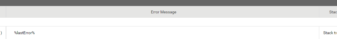

    How do you populate the actual error to the Exit Step? i tried to put lastError variable to Failure Message but it failed, it only show this
    Edit: I solved it by putting a String Variable on Failure Message Thanks!
