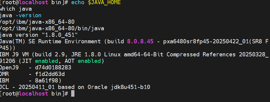

    Then I checked for any JAVA environment variable issues,
    But still, I couldn't find the issue.
