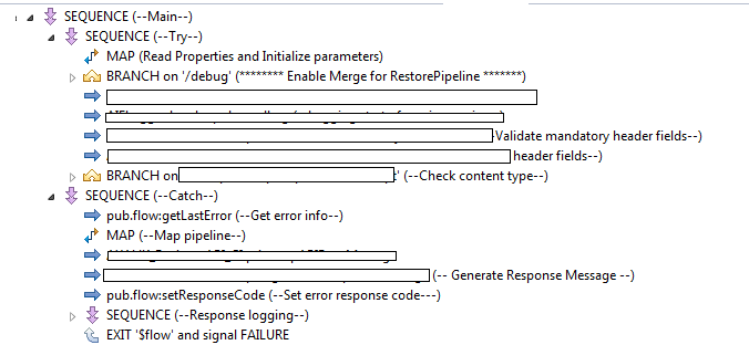

    Hi All,
    I am getting some issue with setResponseCode service. We can use this service to set specific response code for APIs and working fine. But same service when using inside catch block its not working and always setting default response code as 500. Is there any way to overcome this step.
    Please Note: in catch block after using setResponseCode we are using Exit-flow to mark service as failure.
    Thanks

  • 3.  RE: Issue with SetResponseCode
    Posted Mon August 27, 2018 11:02 AM
    Thanks @Mahesh for your reply.
    However I am using wM version 9.7 and there is no option for setResponseCode2 service.
    I am trying to set different http response code other than 500 from catch block .Please find attached screenshot for ref…
    Thanks
    Baharul Islam

  • 5.  RE: Issue with SetResponseCode
    Posted Mon August 27, 2018 11:28 AM
    But at the end of the catch block I need to call Exit-flow to mark service status as failure.
