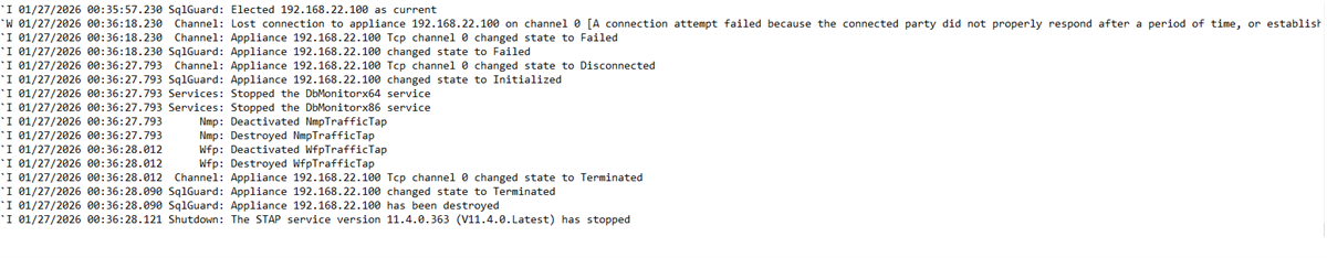

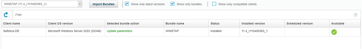

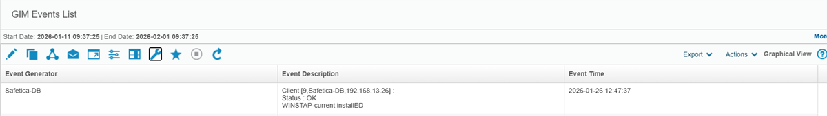

    The GIM agent has been installed successfully and is working as expected. The S-TAP agent is also installed on the SQL Server host; however, it is not displayed in the STAP Control section of Guardium.
    To assist with troubleshooting, I have already collected and reviewed the following logs:
    • stapctl logs
      stapctl
    • services logs
      service
    • setup by client logs
    setup client
    • Gim event
    gim event
    Despite these checks, the reason why the S-TAP is not correctly recognized or displayed in STAP Control is still unclear to me.

    Hi @milad baousi,
    Could you please try with a supported version? We currently support V11.5 and V12.x.
