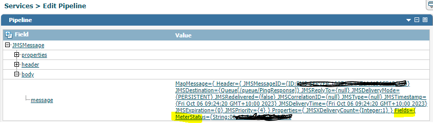

    I’m using JMS trigger to receive MapMessage object. I can see it in MWS audit pipeline, but in the subscribing service, the JMSMessage/body is empty.

    @marinap Its should be available in JMSMessage/body/{object/string/bytes/data/message} . In which ever form you send the message. kindly double check

    Hi Dinesh, in the flow service the body is an empty document without any of object/string.bytes/data/message

    Thank you Dinehs. The body is empty when I save pipeline and look at the file
