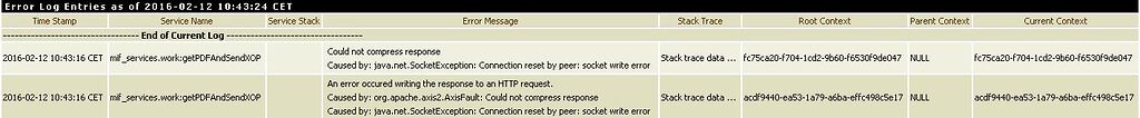

    Hi Vlad,
    Sorry for my late reply…
    Thanks a lot for your help and your files.
    In fact, the other problem I’ve met (and maybe linked) is described here and this time, do not interact in any way with a consumer step :
    Maybe would you have any idea ?
    Regards
