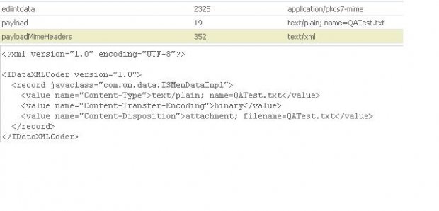

Issue with AS2 payload from Seeburger AS2
  • 1.  Issue with AS2 payload from Seeburger AS2
    Posted Tue May 12, 2009 07:42 AM
    Hi,
    I have transmitted to my vendor who is using webMethods Trading Network. I’m using Seeburger AS2 to transmit a doc to them. However, they cannot processed the payload as they claim there are concatenation of strings after content-type
    payloadMimeHeaders
    text/plain; name=QATest.txt
    *QATest.txt is the test file that I’m sending to them.
    The vendor cannot process it…somehow they can only accept
    text/plain
    Please help how should I resolve this matter in webMethods or Seeburger AS2

  • 2.  RE: Issue with AS2 payload from Seeburger AS2
    Posted Wed May 13, 2009 12:58 AM
    While the use of the name parameter is “discouraged” for content-type in favor of the content-disposition header, it shouldn’t be causing a problem.
    The complaint about “concatenation of strings” seems odd. Can you get the specific error messages or behavior they are seeing and post it? Also helpful would be the version of IS/TN they are using.

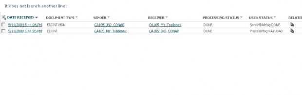

  • 3.  RE: Issue with AS2 payload from Seeburger AS2
    Posted Wed May 13, 2009 08:10 AM
    refer attached for the screenshots

  • 4.  RE: Issue with AS2 payload from Seeburger AS2
    Posted Wed May 13, 2009 07:05 PM
    Looking at the screen shots things appear to be fine. Can you post a screen shot with the payload line selected? Perhaps the entire EDIINT doc? Does the content shown for payload match what was sent?
    What behavior are they not seeing that they are expecting to see? If the payload is not EDI then they need to set up a TN doc type and processing rule to do something with it.

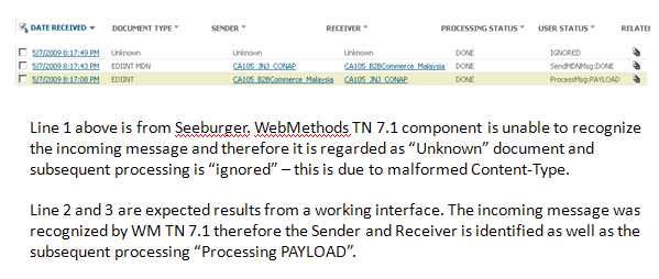

  • 9.  RE: Issue with AS2 payload from Seeburger AS2
    Posted Mon May 18, 2009 09:57 AM
    the incoming document is unable to “enter” the system - it has been ignored by the recognizing engine of webMethods Trading Networks 7.1. The only feeback from the system is Unknown Sender, Unknown Receiver and subsequent processing IGNORED (please see attached image).
    They believe the problem is the Content-Type line does not conform to any MIME document standards that webMethods can recognize.
    Is this a new standard that Software AG is not able to support? Please give the Industry standard for this type of message. Is there any reference to rfc types?

  • 10.  RE: Issue with AS2 payload from Seeburger AS2
    Posted Mon May 18, 2009 05:20 PM
    The content-type with a name parameter is not a new standard. In fact, it is an old one that has been deprecated in favor of content-disposition.
    Are they able to take the exact EDIINT document, remove the name parameter and submit it to TN and it works?
    My best guess is that the attachment is unrecognized because a TN document type for the document that was sent (QATest.txt) was not defined in TN.
    This should work. I have strong suspicions that the name parameter isn’t the problem.
    Can you post the sample EDIINT doc that is failing? Also, what version of IS and TN are they using? I’ll try to duplicate the issue.
    Or, it may be worth opening a ticket with wM tech support.
