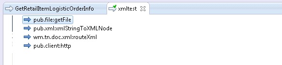

    Now im just reading the file as string with utf-8 encoding then converting the xml string to xml node and then routing the xml node to TN and also at the same time invoking tn:receive service with content type set as text/xml;
    The route to xml fails to recognize the document it is going for unknown PR but the second http call is processing the xml file correctly.
    During wm.tn.doc.xml:routeXml this service call this is the error i have got in the logs.
    [101]2015-11-09 11:36:11 UTC [TNS.0001.2088I] A corrupted document was encountered in recognition: There was an error in trying to get XML header information (DOCTYPE and DTD). The document (5ec14k00a3m0gcri000003mq) is probably not valid XML.
    [100]
    [99]2015-11-09 11:36:11 UTC [ISU.0000.9999E] com.wm.app.tn.doc.CorruptXMLException: There was an error in trying to get XML header information (DOCTYPE and DTD). The document (5ec14k00a3m0gcri000003mq) is probably not valid XML.
    i have attached the snap shot of the code.
