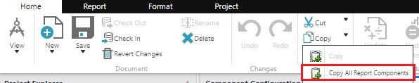

    @Menno Wittebol, For #2, follow these steps
    • Check out the report in Trunk which you would like to copy.
    • Once checked out, use the 'Copy All Report Components' function to copy the entire report (see screenshot).
    • Switch to the respective branch.
    • Click New, Report and label whatever you want to name the report.
    • The Paste window at the bottom right should still be visible to your workspace.
    • Click Paste All. Save the report and check in your report.
    Hope this helps.
