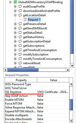

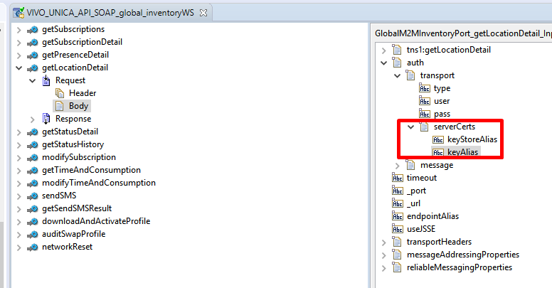

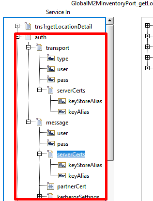

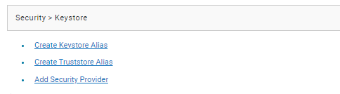

    But, how can I set our Integration Server to use a specific certificate when calling an operation of this WS?
    I can see in Designer the following properties:
    When called in the flow service:
    And this screen on IS admin page:
    Are the above places the correct ones to set to use the pfx while doing the request?
    Or, does exist a correct/better way to do it?

    Hi, both places pointed out above are the right ones when it comes to setup SOAP calls using SSL authentication.
    Additionally, I recommend taking a look at Web Service Developer’s Guide. The following chapters may give you further clarity on how to solve it:
    • Signature for a Web Service Connector
    • Passing Message-Level Security Information to a Web Service
      Connector

    @moacy.barbosa thanks for your return.
    With the guide that you provided, I managed to set and call the SOAP service via our Integration Server.
