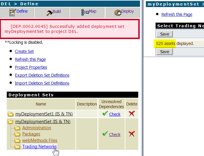

  • 9.  RE: IS Deployer - Deployment Candidate not visible
    Posted Fri November 27, 2015 10:20 AM
    I asked our consultant about this EOS policy regarding fixes available through updater.
    I found another problems with Deployer after installing DEP_8.2_SP2_Fix15 (…both visible on picture in attachment):
    1. First DeploymentSet I create within project is useless, as I cannot select any Type of assets to choose from (Packages, webMethods Files, …) Second one is ok, BUT:
    2. no TN assets can be added from our IS DEV server. Strange is, that i can select assets from Test/Prod servers, where the same DEP fix resides. Also WmDeployerResource is distributed in same version accross all environments.
      SAG claims that such issue should be resolved by DEP_8.2_SP2_Fix17 (which I don’t see in updater). I tried many things but still no change. Rolling back the fix doesn’t seem to be a good option either.
      I guess you didn’t run in similar situation, did you?

  • 10.  RE: IS Deployer - Deployment Candidate not visible
    Posted Fri November 27, 2015 10:34 AM
    Hi Lukas,
    did you try a double click on the set which seems to be useless?
    In most situations I have seen such behaviour (even in 7.1.x, I am not sure with my 9.5 currently), this could be solved with a double click.
    Regards,
    Holger
    #Integration-Server-and-ESB
    #webMethods
  • 11.  RE: IS Deployer - Deployment Candidate not visible
    Posted Fri November 27, 2015 10:52 AM
    Thanks Holger, that actually works :slight_smile:
    the problem with missing TN assets is the main problem though. Now we only can export-import TN assets…
