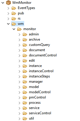

    We already have the “WmMonitor” package as you can see below:
    And there is a lot of services in those folders.

    the services you are looking for are in the wm.monitor.archive folder, you can invoke them from IS Admin when browsing the package contents for WmMonitor.
    You will need at least wm.monitor.archive:serviceArchive and wm.monitor.archive:serverArchive for the tables you want to reduce.
    Remember to inform your DBA after deleting the data that he should analyse the IS core schema to get the tablespace freed.

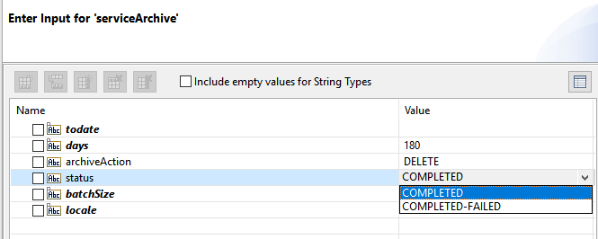

    Thanks for your advices. I managed to enable My webMethods Archive Audit and I managed to do the “serverArchive” proccess.

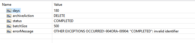

    But, I’m receiving the following message when trying to execute “serviceArchive” (which deletes data from WMERROR - the biggest table):
    Is there anything that I must do to fix this error?

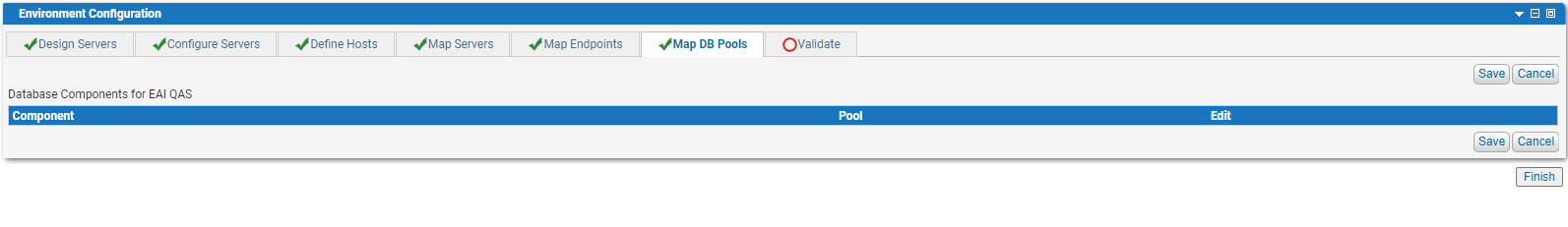

    Also, in myWebMethods, there isn’t any DB Pools in “Define Environments” section (is this normal?):

    the Environment config shown here only applies when you are using Optimize (for Infrastructure and/or Process).
    When you are just want to archive this is not relevant.

    the JDBC Pools in “Define Environments” in MWS are only relevant when using Optimize products.

    Status should be COMPLETE , not COMPLETED , Plz change the status to COMPLETE

    Thanks Sridhar for the response. But, unfortunately, the java service only allows me to select “COMPLETED” or “COMPLETED-FAILED” as you can see below:
