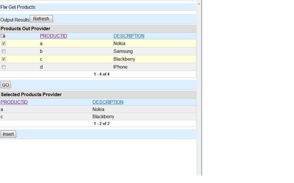

    I have a view that displays data via a web services from various tables of my local database. I am able to select rows using checkboxes and display these selected rows an async table within the same view.
    What I actually need to do is insert some of the fields of the selected rows into another table in my local database.

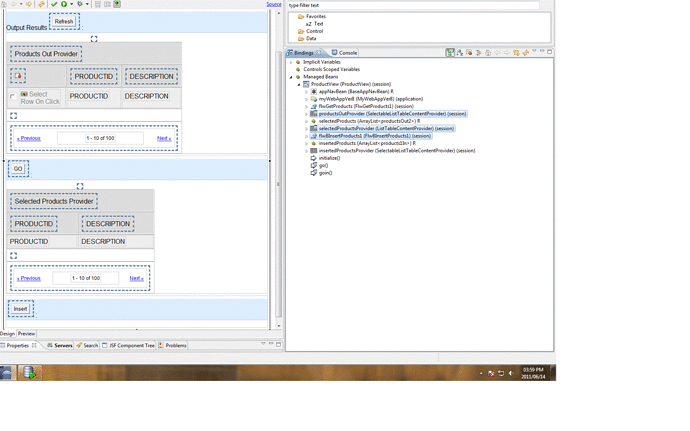

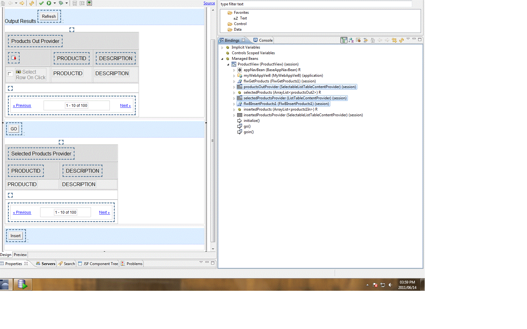

    I have a content provider from an insert web service (test manually and able to insert a list of rows) and an action that assigns to the input parameters of the the content provider - the output results of my selected rows - but I’m getting various errors.
    Can someone please help…
    I’ve actually resorted to a simple test case that gets all rows from a table “products” and inserts selected rows from a view into a new table products1…
    See attached - “testCase” (the design) and “Results” - results of testCase…

    I am building a portal to view (V), print(P) or reprint (R) purchase orders (PO) for all vendors of our organisation. The services and portal is almost completely designed and I am now at a point of selecting rows of displayed PO’s to do one of V,P or R.
    Some background :-
    1. I have only about two Months of webMethods experience - CAF -only just started :roll:
    2. Data is extracted from numerous tables in our SAP database and stored in our local webMethods Oracle database.
    3. I have adapter, flow, web services that extracts data that’s required to be displayed.
    4. I have a batch insert adapter service with it’s web service for inserting selected records into a history table in my Oracle database.
    5. I am able to select rows and simply display these in an async table on the same view but when I attempt to use an action that inserts into my history table - I fail - I tried everything I know possible.
    So the test case described in my initial post was simply to prove the concept of inserting selected rows into a database table.
    I thought that a good route to go would be recreating the current situation and therefore attached all the design through the bindings view.
    Hope this makes things clear…

    Hi Mark,
    Basically,
    1. My web service “flwGetProducts” gets the products data from the products
      table in my database (using a flow service Get Products via it’s JDBC select
      adapter service)
    2. I create a content provider “productsOutProvider” to display the above results
      on my view. (Here I insert the select row checkbox - leaving me a point 6d of
      your tutorial 1)
    3. I then follow point 7 thru to 11 to achieve my attached “results” in my initial
      post.
      3.1. My page bean property name = selectedProducts
      3.2. Code for getter method - getSelectedProducts is :
      public ArrayList getSelectedProducts() {
      if (selectedProducts == null) {
      selectedProducts = new ArrayList();
      resolveDataBinding(SELECTEDPRODUCTS_PROPERTY_BINDINGS,
      selectedProducts, “selectedProducts”, false, false);
      return selectedProducts;
      3.3. My code on my go() action that displays selected rows is :
          public String go() {
      List selectedRows =
      this.getProductsOutProvider().getSelectedRows();
      if (selectedRows != null && selectedRows.size() != 0) {
      for (Iterator iterator =
      selectedRows.iterator(); iterator.hasNext(); ) {
      productsOut2 p = (productsOut2) iterator.next();
      selectedProducts.add(p);
      return OUTCOME_OK;
    Now, what I need to do is instead of displaying these selected rows - I want to insert them into another table “products2” in the same database that I am retrieving the initial products data…
    So I have -
    1. An batch JDBC insert adapter service to insert into Products1 table
    2. A flow service - using this JDBC from which I create my web service
      “flwBInsertProducts1” (flow Batch Insert into Products1)
    My question is how do I pipe my selected rows into this web service flwBInsertProducts1?
    I attempted this by creating an action goin() and in my data flow implementation I assigned the selectProducts list fields to my input parameters of my flwBInsertProducts1 webservice.
    It’s just this last bit that I’m stuck with - for weeks - pls help :cry: It just can’t be too difficult from here and that’s why I asked -
    Do you know -
    1. if a web service using a batch insert adapter service works?
    2. if there may be any bugs/fixes regarding action implementations?
    Hope this makes things more clearer…
    Thanks
    V
