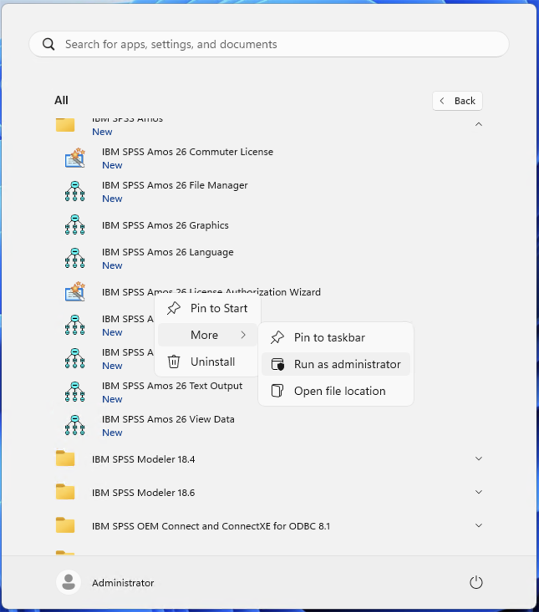

    Hi @Erica Liem,
    Assuming you already obtained your authorization code from wherever you purchased Amos, use the License Authorization Wizard.
    Note: Amos needs to be installed as an Administrator.  Similarly, only an administrator will have the proper privileges to update the license file. Right click on the License Authorization Wizard and launch it "Run as Administrator"
