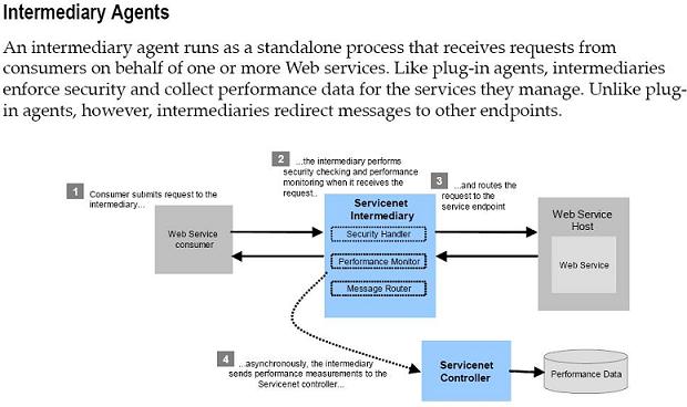

  • 6.  RE: Implement WS Security in Integration Server (Flow Service)
    Posted 02/10/06 06:48 PM
    Diagram of webMethods ServiceNet as an intermediary “upstream” of the web services provider is attached.
    In this role, ServiceNet can provide the functions of WS-Security (decryption, signature verification and authentication) before the web services consumer receives the message.
    The ServiceNet User’s Guide is available on webMethods Advantage.
    Mark
