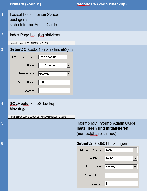

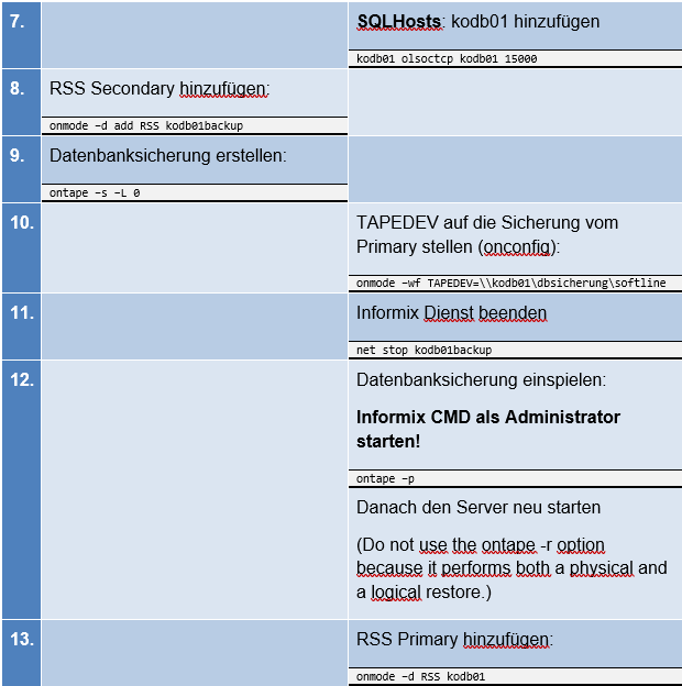

    Hi,
    im trying to create a RSS instance with ids 14.10 following this guide:
    https://www.ibm.com/support/knowledgecenter/SSGU8G_14.1.0/com.ibm.admin.doc/ids_admin_1000.htm
    With 12.10 this steps are working fine, but with 14.10 i'm not able to bring the rss instance online.
    It fails with following messages:
    onmode -d RSS xxxx
    RSS Server did not successfully start. onmode: Please check the message log for errors.
    onstat -m
    IBM Informix Dynamic Server Version 14.10.FC3WE -- Fast Recovery -- Up 04:20:39 -- 9072384 Kbytes Message Log File: C:\Informix\xxxx.log 09/03/20 08:29:14 Maximum server connections 0 09/03/20 08:29:14 Checkpoint Statistics - Avg. Txn Block Time 0.000, # Txns blocked 0, Plog used 0, Llog used 0 09/03/20 08:29:16 Physical Restore of rootdbs, softlinedbs, jbpmdbs, llogdbs, plogdbs, sblobdbs Completed. 09/03/20 08:29:16 Checkpoint Completed: duration was 0 seconds. 09/03/20 08:29:16 Thu Sep 3 - loguniq 14535, logpos 0xf534018, timestamp: 0xf90105f Interval: 429036 09/03/20 08:29:16 Maximum server connections 0 09/03/20 11:05:32 DR: new type = RSS 09/03/20 11:05:53 System Error: Wait on network event fai led 09/03/20 11:05:53 Socket: 468, Mask: 16, Error: 10060 09/03/20 11:06:33 DR: Trying to connect to server, xxxx. If the specified server is not in Online mode, bring it to Online mode. 09/03/20 11:06:33 Data replication type and state information reset. To start DR, use the 'onmode -d' command and wait for the pair to be operational, before shutting down the database server 09/03/20 11:06:37 Defragmenter cleaner thread now running 09/03/20 11:06:37 Defragmenter cleaner thread cleaned:0 partitions 09/03/20 11:13:39 WARNING!!! Not building 'sysha' database because 'sysmaster' database is missing.

    Hi Art,
    yes, i used the same steps as i used before with 12.10 instances:
    Josef Albert
