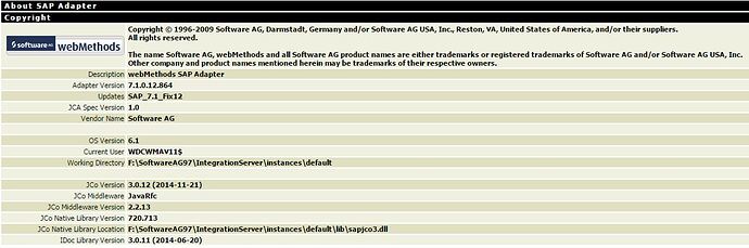

    which Version of SAP Adapter are you using? I assume 7.1, as you are on IS 9.7.
    Please make sure that you have applied the recent Fix (Fix10+) and the appropriate JCo-Libs (3.0.12+) incl. IdocJco-Jar.
    Shutdown and Start the IS after adding the files (see SAP-Adapter Administrators Guide for Details).
    Please share these informations (Fix-Level and JCo-Version) from the SAP-Adapter About-Page.

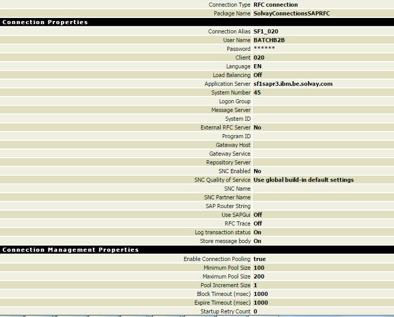

    Make sure you have configured Connection and Listener to store transactions and their bodys.
    After that you can investigate these in SAP-Adapter-Admin under Transactions.

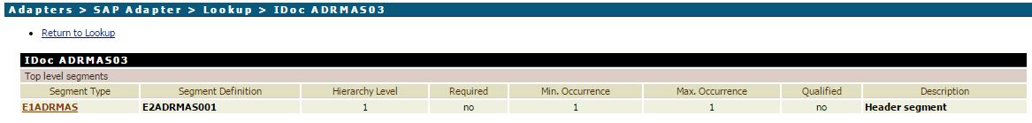

    What happens if you try to Lookup the Metadata for your Idoc-Type in the SAP-Adapter-Admin?
    Is it shown in the DDIC-Cache?

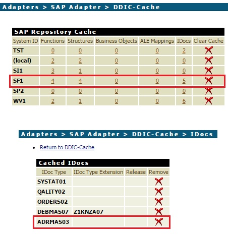

    We have configured Connection and Listener to store transactions and their bodys but the IDOC is not visible in Transactions page.
    I have attached the screen for Lookup & DDIC-Cache.
    Let me know if you required any further details.
    Appreciate your help…

    can you share the About-page of the SAP-Adapter as a screenshot please?

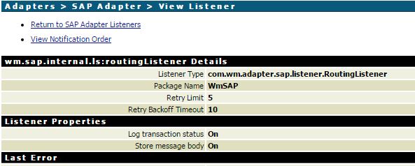

    Can you share the configuration of connection and listener?
    Are there any other error messages in the server.log?
    Remove the Idoc type from the DDIC cache and do a new lookup.
    This soemtimes solves issues when the Idoc type changes on SAP-side and the SAP-Adapter does not pick up the changes.

    I have attached About page for SAP Adapter.
    Also could you please confirm, I need to delete the IDOC Type from Adapters > SAP Adapter > DDIC-Cache > IDocs > Cached IDocs correct?

    To answer the earlier question:
    Yes, delete the Idoc from the DDIC-Cache (Adapters > SAP Adapter > DDIC-Cache > IDocs > Cached IDocs) and then do a fresh lookup.
    BTW: this DDIC-Cache is deleted and recreated ayway when the IS starts or when the connection is disabled and enabled again.
