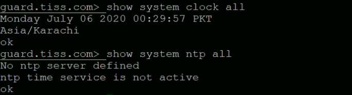

    Can you share what's the output of
    show system ntp all
    show system clock all
    show system ntp diagnostics
    If you disable the NTP server, does local time stays as you manually set it to be, after 24 hours?

    Hi Daniel, I am not using any ntp server for time synchronization. I am setting local date and time manually using command: store system clock datetime <date-time>.
    Also I am attaching the results of commands you asked. In this screenshot you can see, Guardium date time is 4 hours ahead of my current local time.
