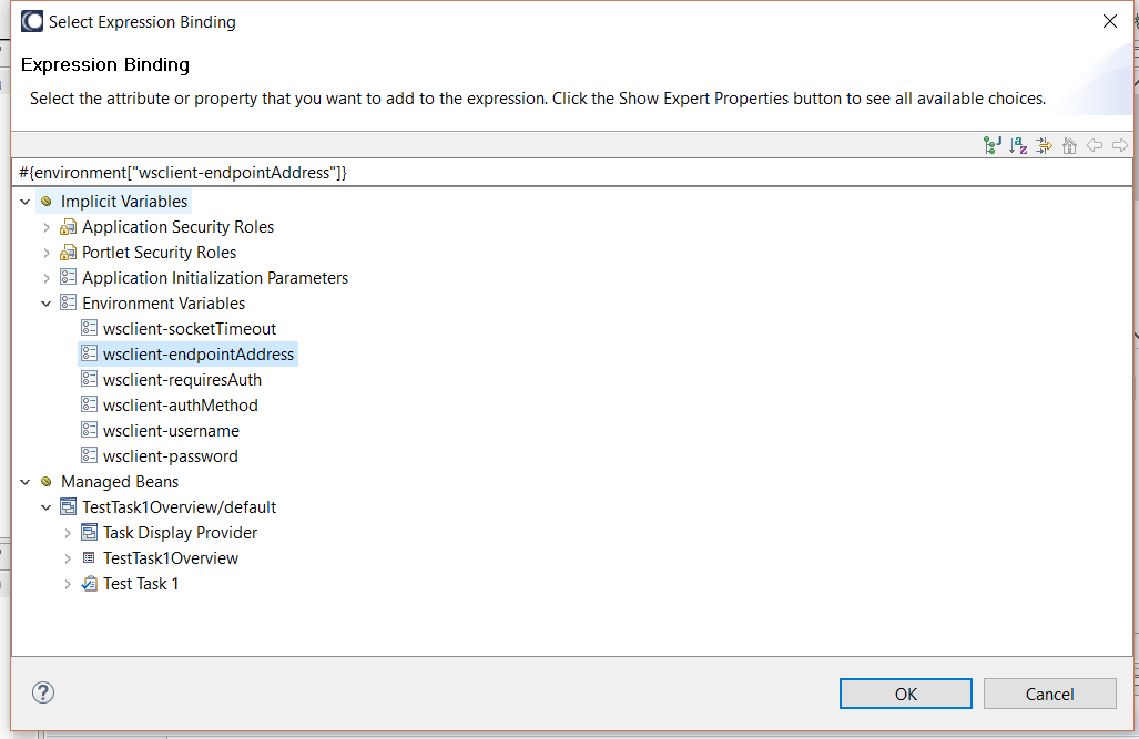

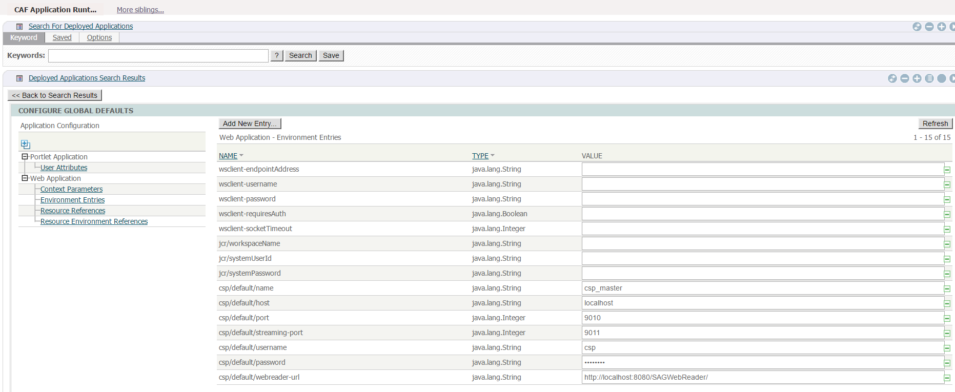

Now since it is accessing the old test server i updated the wcclient-endpointAddress to my new server details as shown below:
http://:/ws/
