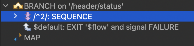

    Use a branch with a switch value
    Then in the label attribute of the embedded step, use /local/
    as a regex
    I often use something similar to filter for all good https responses with /^2/
    Screenshot 2021-04-28 at 08.50.19
    regards,
    John

    This variation will ignore case and be “true” if the substring “local” appears anywhere within the variable value: /(?i)local/
