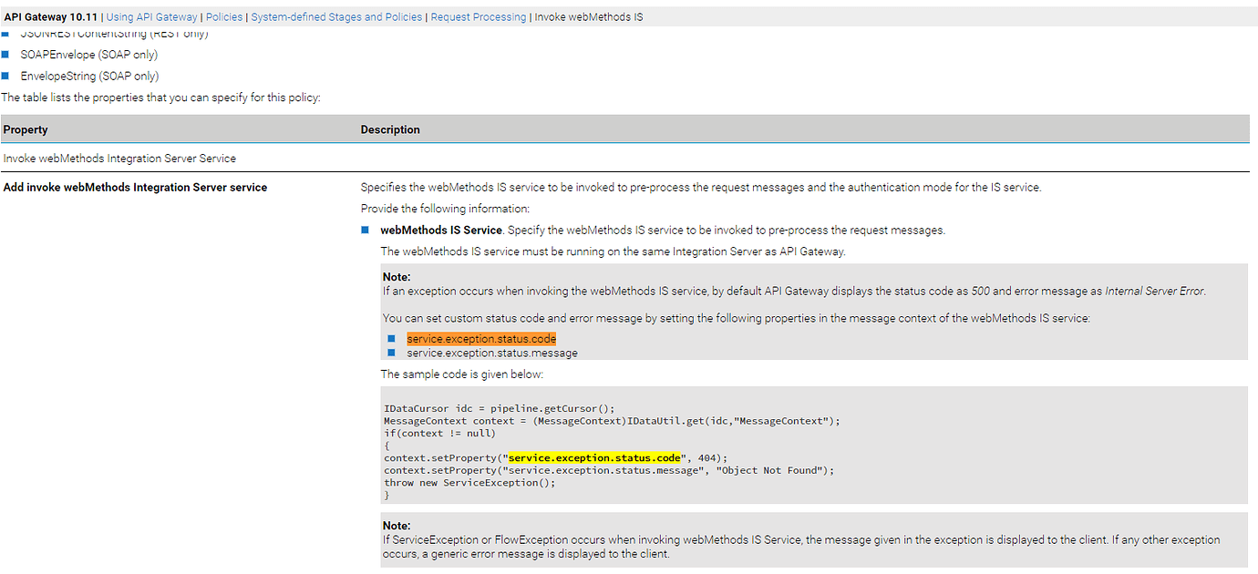

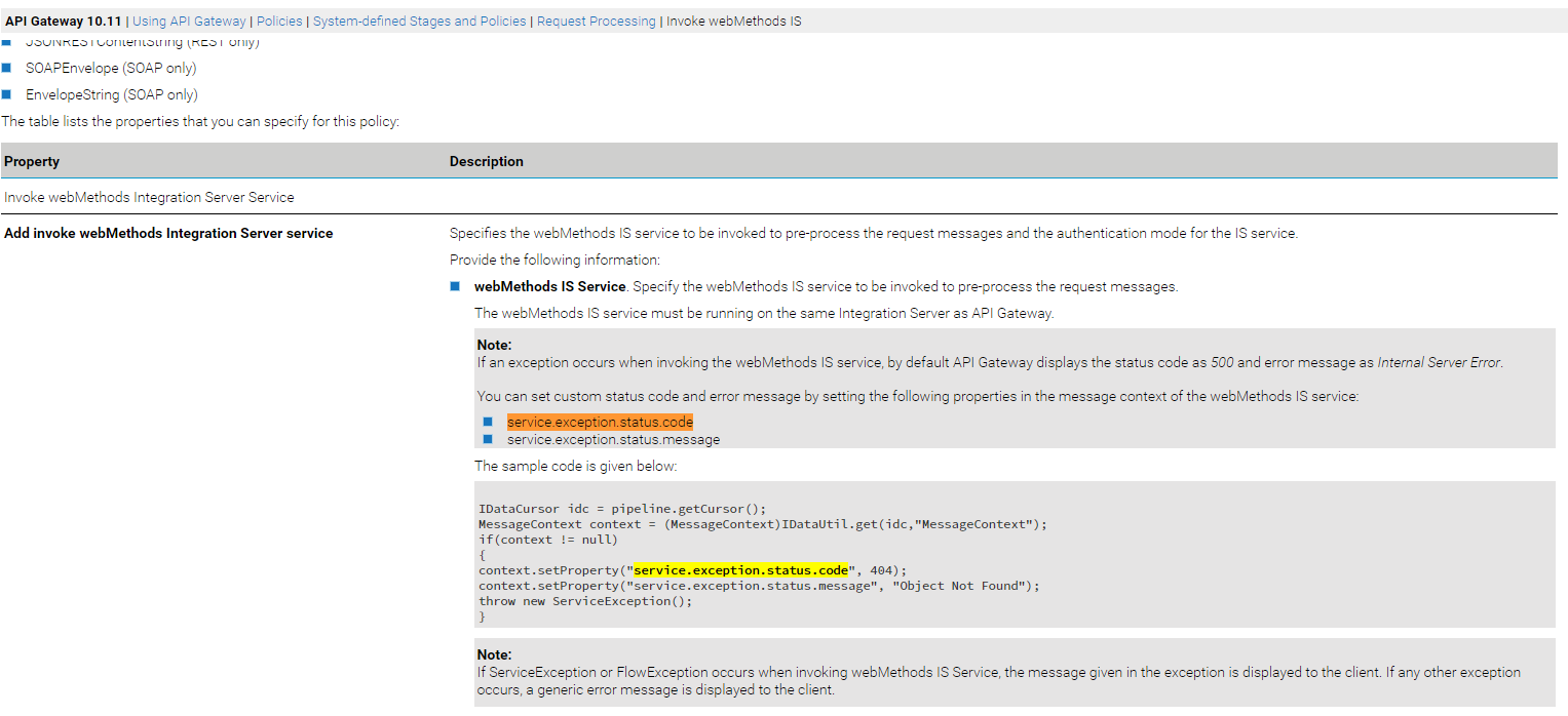

    You can set the “service.exception.status.code” and “service.exception.status.message” in the message context to achieve this. I am pasting the screenshot from the document below. Hope this helps.

  • 3.  RE: How to reject request correctly in API Gateway Invoked webMethods IS?

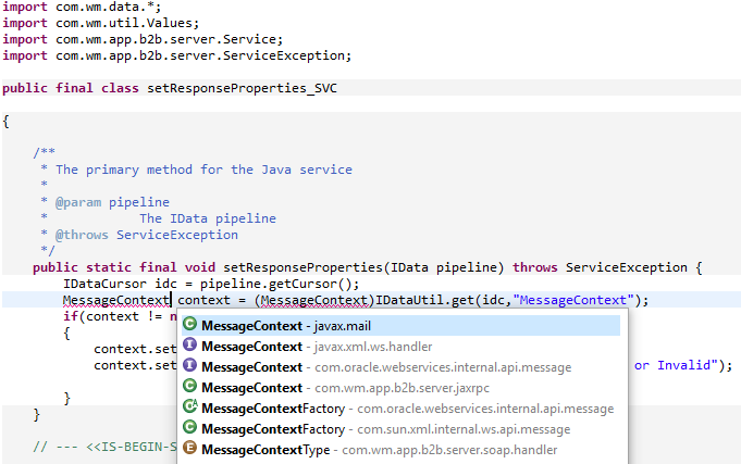

    I tried this before but i’m not able to find the right class to use
    I tried all suggested class but doesn’t resolve the error :frowning:

    For writing IS service programmatically (usage of MessagContext) etc, you can refer this article and the IS package attached here. Invoke webMethods IS policy in API Gateway 10.1 and below
    In your case, the MessageContext you need to import is “org.apache.synapse.MessageContext”.
    Add the below jars in the build path for the package in Software AG Designer.
    • axis2-kernel-.jar, axis2-transport-http-.jar and synapse-core-*.jar from <Install_Location>\WS-Stack\lib
    • <Install_Location>\IntegrationServer\instances\default\packages\WmAPIGateway\code\jars\apigateway-runtime.jar
    • <Install_Location>\IntegrationServer\instances\default\packages\WmAPIGateway\code\jars\static\apigateway-API.jar
    The above changes are to resolve the compile time errors thrown by Designer during edit and save of the java services inside the package. Also, make sure wmAPIGateway package is added as the package dependency to this package (this is for runtime).
