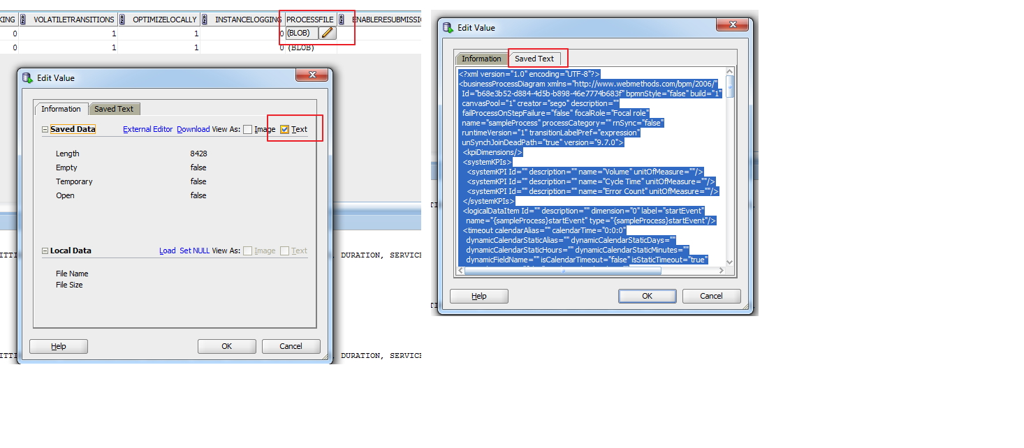

  • 16.  RE: How to get process model from MY webmethods and Integration
    Posted Fri April 10, 2015 10:33 AM
    Naresh,
    Exporting .process file (xml data) from WMPROCESSDEFINITION is the right approach if you do not have the latest process with you. Exporting it from database is simple using tools like SQL Developer. Do not complicate by creating adapter, converting byte array etc.,
    Screenshot attached that describes how to extract the blob data from db table.
    -Senthil
