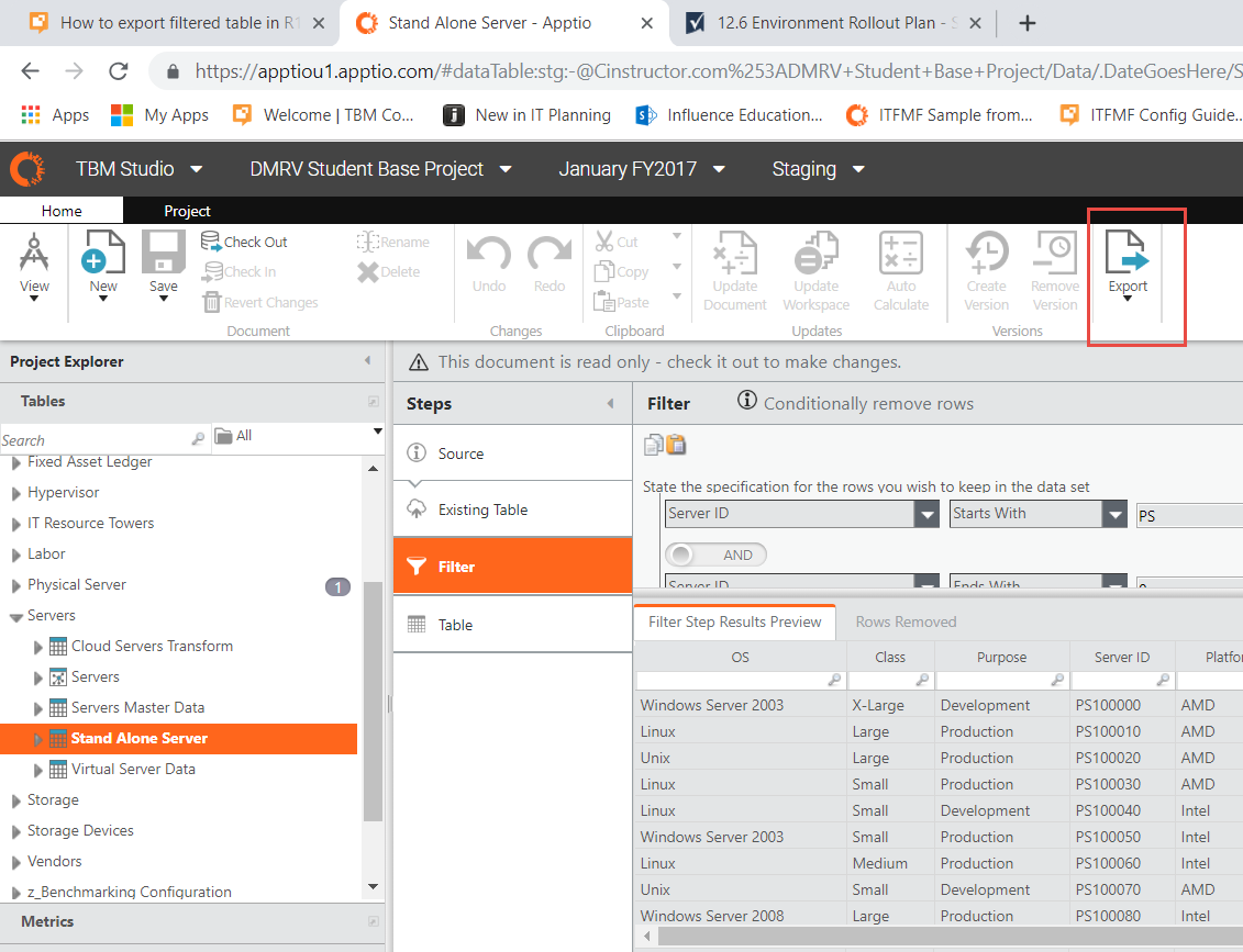

    Not on R12 yet, but had a question.  In the table step of the transform pipeline, if I filtered that data, can I still right-click on the header to export the filtered data like in R11 or has that changed?  Thanks so much!

    Hi @Jenny Franklin and @Eduardo Tirado,
    Thanks for the question. Yes you can do that in R12 but it's a little different.  You need to be on the home tab for a selected data set (or filtered data set).

    Using that Export function exports the entire table - all columns and all rows... I believe what @Jenny Franklin wants is the ability to filter a column in the Table step, and then only export those lines. I don't believe this functionality exists yet. We requested a RFE for this a while back and encourage you to do the same to help expedite it.
    If you're pipeline is simple (like the one above), just temporarily add the column filter you want to the Filter step, then export and revert the change. But if you're pipeline is complex (e.g. the Filter step is early on and there are multiple steps afterwards), there's no way around this that I'm aware of - have to export the entire table then filter in Excel.

    Alternatively, you could create a new table based on the existing one and then add a Filter step and a Hide and Rename step (if you only want certain columns) and then export that one.. Might be easier working within Apptio rather than Excel if the dataset is really large..

    Should be able to filter at the columns that you want filtered then right click at header and open in Excel to get the filtered data only

    In r11, yes.. But not in r12..

    So I talked to the CT Dream Team (@Mark Nealey, @Chris Rhoades and @Ryan Paul ) since I had them all in the room - they agree, we can't get the filtered results however, there is a bug filed on it.  So perhaps it will be in a future release.

    The Export feature should export the data shown from the Preview tab (in any step), the Rows Removed tab, or final output of the table...driven by whichever is displayed.
