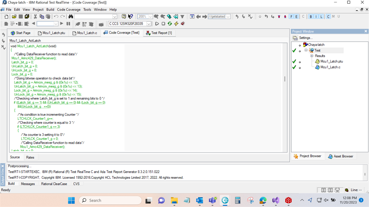

    Hi,
    I am using RTRT tool for doing code coverage. In my code I am using nested if conditions, in that one of the if condition is not getting covered.
    In this code first 2 if conditions are getting covered then after for loop if condition is not getting covered. For both the if conditions I am using same global variables but data will be changed.
    I need a help for how to cover this if condition also.
