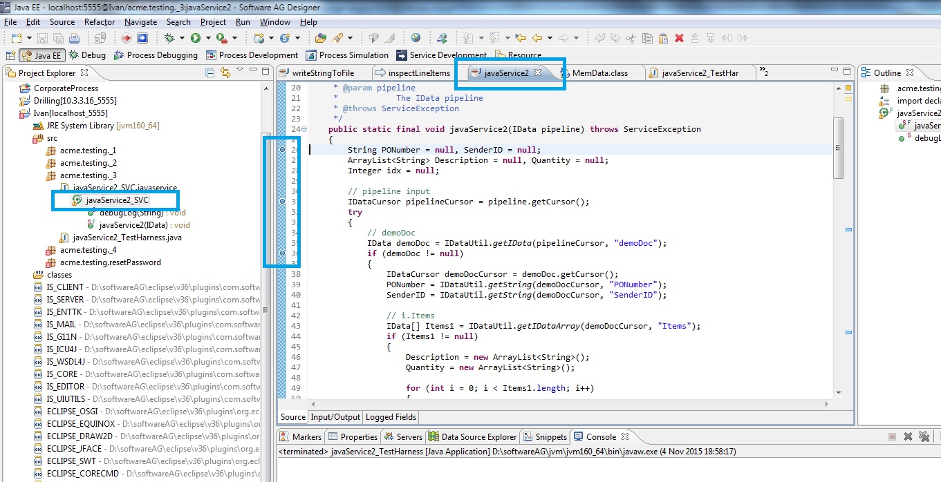

    By using webMethods Designer (eclipse) you can do several steps:
    1. You need to create a java class which is serves as called “Test Harness”, first of all to make your work lot easier, do this by changing your eclipse perspective to JavaEE.
    2. Right click on your javaService working window which you want to generate a test harness, and click to Generate Code. In the Code Generation window, choose “For debugging this service” option and click Finish.

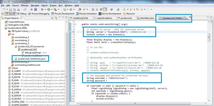

      Designer generates the test harness with a single main primary method and displays it in the debugger editor. (picture #1)
      Optionally update the “Test Harness” class param as necessary to which the test harness will connect to. For instance: change the server name, username & password entry
      Save for any change(s) you’ve made.

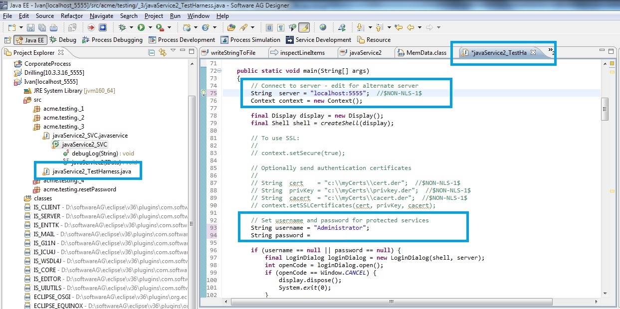

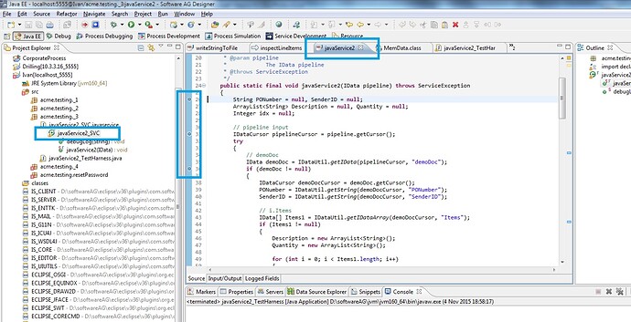

    3. Select breakpoint(s) on your javaService earlier (picture #2), and back again select your TestHarness java class and click on debug (or right-click for debug as java application).

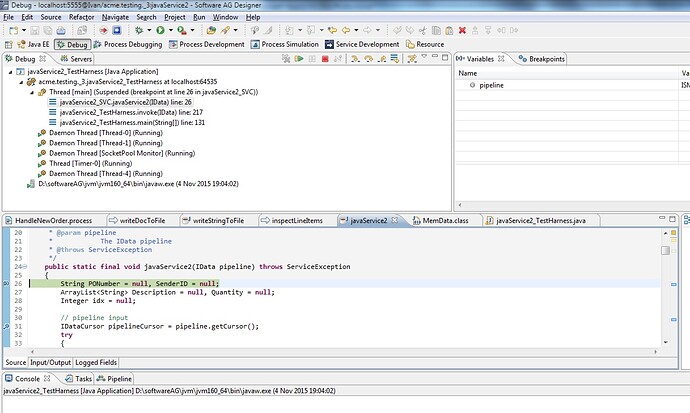

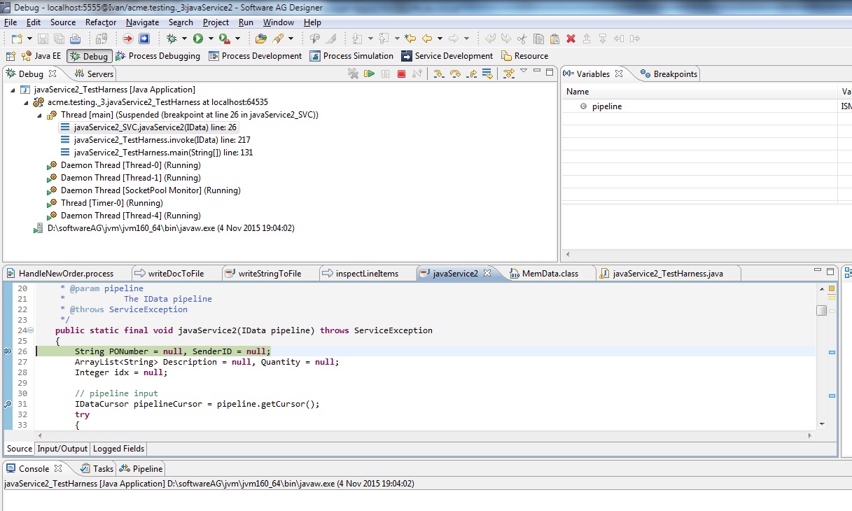

    4. When you launch the Java class in debug mode and the debugger encounters a breakpoint, it suspends execution. At that time, if the Debug perspective is not already in use, Designer switches to it (picture #3)
    This is it! Finally you can debug your Java Services in Designer (eclipse)
