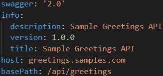

    By the way, to have the IS automatically generate the URL alias when you import the Swagger file, add the path you want to use as the basePath in the swagger, e.g.
    The URL alias definition is stored in the file config/urlalias.cnf inside your package, so when you deploy the package to higher environments, the URL alias gets created automatically.
