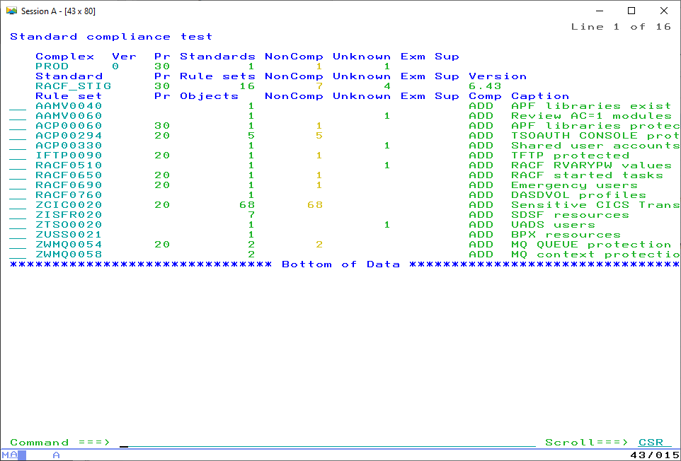

    Next, in many of the reporting panels you can select Show differences under Output/run options, and select the type of differences you would like to see.  When you use this in AU.R.E, the report shows compliance rules where Tests or Objects changed.  This could point to new objects, or to tests that changed in compliance posture (e.g., became non-compliant).
    The result is not easy to understand for managers.  However, the security analyst can use it to spot resources that were added or the effect of incorrect security administration.  This example shows that one new APF  library was found, and it is compliant for the requirements of AAMV0040 (there in no "NonComp" value), but it fails some tests in ACP00060 (See the yellow 1?).  68 (new) issues with Sensitive CICS transactions were uncovered, etc.

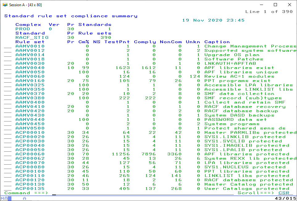

    A compliance progress report could be found in the Rule set compliance summary  display that you can get from AU.R.E.   It shows a Cm% column that indicates the percentage of Compliant tests in the evaluation of this system.  The percentage is designed as an indicator of the effort needed to achieve a 100% compliant system.

    Like you have on this panel:
    AU->R->E->STDTESTS
    Before you select a standard.
