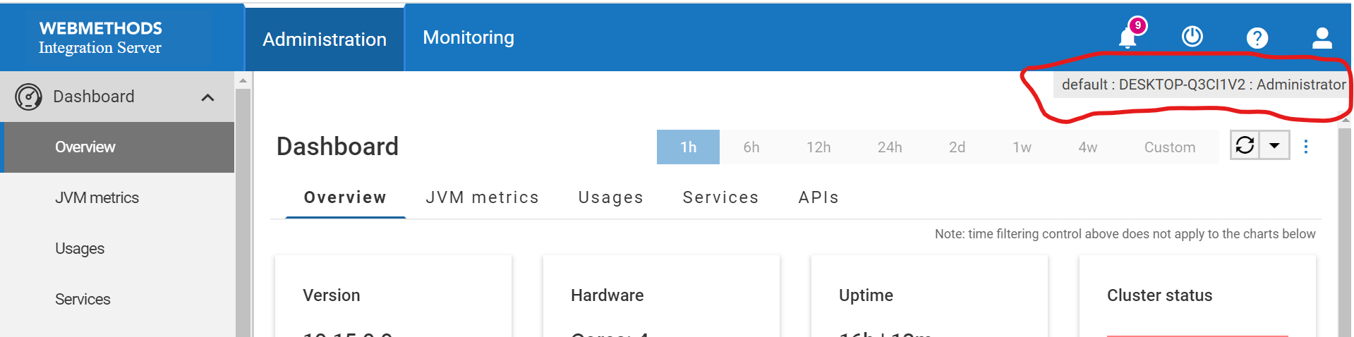

    Hello @John_Carter4 .
    Thanks for the response.
    I have changed the hostname via the operating system as you have suggested, and it got changed too.
    But, there were some issues because of that. like
    1. in JDBC POOLS, while testing Pool Alias Definitions they were getting failed.
    2. in Adapter >> webMethods Adapter for JDBC , here the connections we created
      were not getting enabaled.
    i am attaching a pic to see that IS server name is changed compared to before.
    but JDBC pools connection is getting failed.
    If there is any other method to change the IS server name without affecting any dependencies, please share.

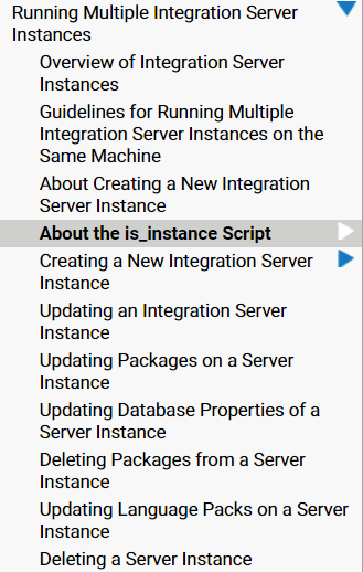

    If you mean the “default” part of it, then you can use the IS Instance Manager to create a new IS instance. You will have to delete the “default” instance after taking a backup of any packages, configuration, etc., and create a new one with a different name -
    1. About IS Instances (link)
    2. Script Commands (link)
    3. If you open the aforesaid links, there are more pages on the left side panel, that explain more

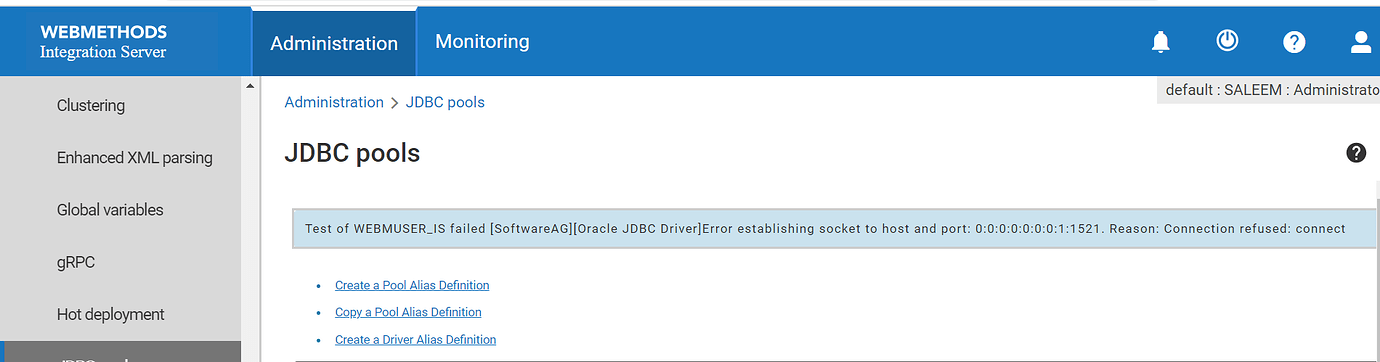

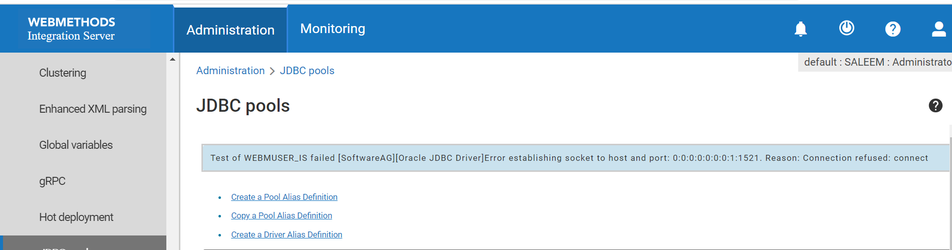

    Hello @Venkata_Kasi_Viswanath_Mugada1 .
    Thanks for your response.
    But i am not looking to create a new instance, i just want to change the name of the current default instance that i am using.
    As @John_Carter4 suggested in the previous response, IS name got changed but those changes are causing other issues like failing of JDBC POOL connection & not being able to enable connection in the Adapter >> webMethods Adapter for JDBC.
    for getting clear understanding please check the 2 pic i attached.
    If you know any method o change the IS server name without affecting any dependencies, please share.

  • 6.  RE: How to change the default IS name
    Posted Wed October 11, 2023 06:00 AM
    It’s a hostname change, so if your databases are running on the same machine, then they will be impacted -
    1. Update your database configuration and restart it if needed (link)
    2. Update the database hostname under JDBC Pools
    3. Restart the IS
    A screenshot of your “WEBMUSER_IS” JDBC Pool configuration will help check if the above is the case.

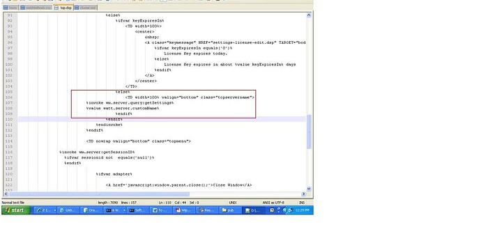

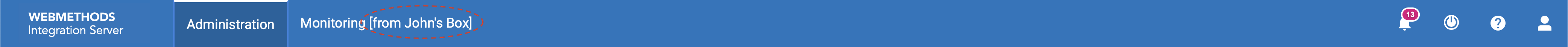

    @Nagendra_Prasad, well it is useful to be able to refer to a server with a sensible name, ofter host names can be unintelligible and difficult to distinguish production from development environments. @saleem_malik my apologies for not pointing out that you changing the host name can have major impacts :frowning: Also I would add that in many cases it isn’t possible to rename a server in this way.
    In the past it would have been super easy to customise the HTML page directly, however now that we have adopted angular it is not possible. You could try modifying the css file styles.0ba5e6fcf6773fb937b5.css and change the nabber background color to make it easier to distinguish test from prod etc.
    The only thing I can think of that is relatively easy to do is to edit the localisation files to do something like the following
    To do that edit the file
    <SAG_HOME>/IntegrationServer/instances/default/packages/WmADMIN/pub/assets/i18n/masthead/en.json
    Then edit the value for “masthead.monitoring”
