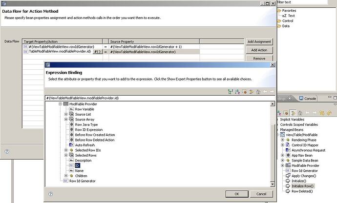

  • 4.  RE: How to add rows (with data) to a simple table
    Posted Mon December 07, 2009 10:49 AM
    Hi,
    one other option you have is to create an action and bind it to the “Before Row Created Action” in your Table Content Provider. In that action you will initialize the contents of the created row (simplest way, if possible, using the Data Flow wizard… see the attached pic). This action will be called:
    • inmediately if you used the “Create Row” action, as described by Sunil
    • when another action is called in case you used the client side “Add Row Button” control.
    hope this helps,
    Javier
