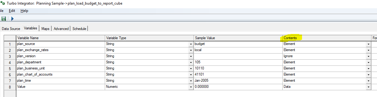

    @Shubho Ghosal, One more quick thought on your original question.   Assuming you are using the Ti editor in Architect or Perspectives, you need to set the Contents type of the variable to determine what part of the script the variable can be used in.  I think most modelers probably use the Other  type, which makes the variable available everywhere in the Ti.
    Again, you probably want to destroy or just empty the dimension in the Prolog section, and then add elements and set the parent-child relationship  between elements in the Metadata section.
    One more small hint...both the Metadata and Data section of the Ti process run once per record in the data source.  Modelers will often try write code only in the Data section and leave Metadata blank for best performance.  Your mileage will vary on this depending on what your Ti code is doing.  You might want to test it both ways (code in Metadata and Data vs code just in Data) to determine which is best.  See the documentation here: https://www.ibm.com/support/knowledgecenter/SSD29G_2.0.0/com.ibm.swg.ba.cognos.tm1_ref.2.0.0.doc/r_tm1_ref_tifun_dimensionelementinsertdirect.html and https://www.ibm.com/support/knowledgecenter/SSD29G_2.0.0/com.ibm.swg.ba.cognos.tm1_ref.2.0.0.doc/r_tm1_ref_tifun_dimensionelementcomponentadddirect.html
